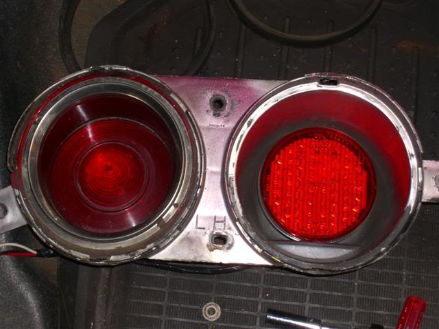

You should really go LED!!! They are soo much brighter,
here's a pic of a 4" round truck/trailer LED sitting in my taillight bucket, it sits in perfect and the stock lens sandwiches it snug so I didn't even have to use silicone or anything to hold it:

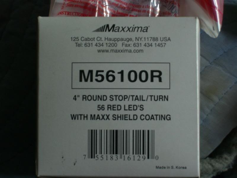

Here's the model of LED I used:

Thanks Norcal, i'm diggin that, I will do that in the near furture, I like the stock taillights and the fact you dont have to mod them, the others look cool too, i just prefurr the stockers. thanks for the pics and part #s I'll be on it.
