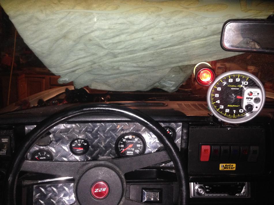

i was told that you cant have a psi gauge that has fuel running to it inside the cab of the car if you want to run at the track. is this true? it sounds legit to me. Also what do you think of the dash i made.IMG_0839.jpg

Yes, that's correct, and a very good idea too! You have the option of electronic, or mounting it in a weatherproof pod outside if you really want to watch it. I've always mounted mine to my fuel pressure regulator in the engine bay so I could see it as I set the pressure. Never felt I needed to watch it constantly while racing or driving.
I like custom gauge panels, but I'd prefer a smooth aluminum myself. It looks a little "industrial" in diamond plate.
