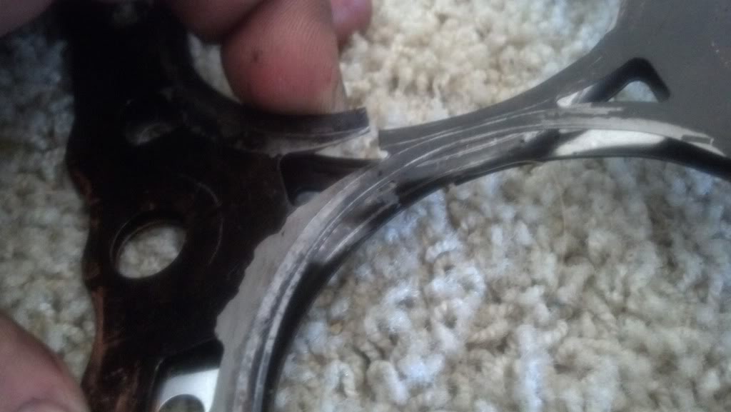

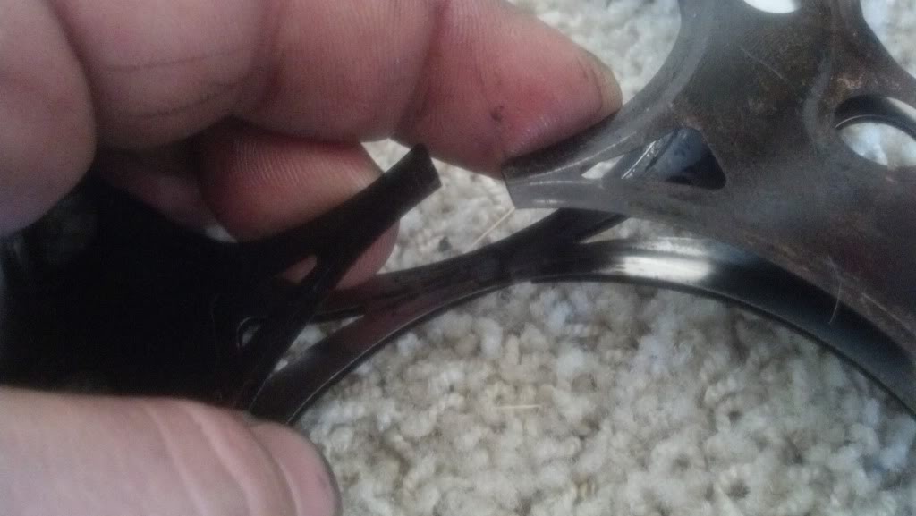

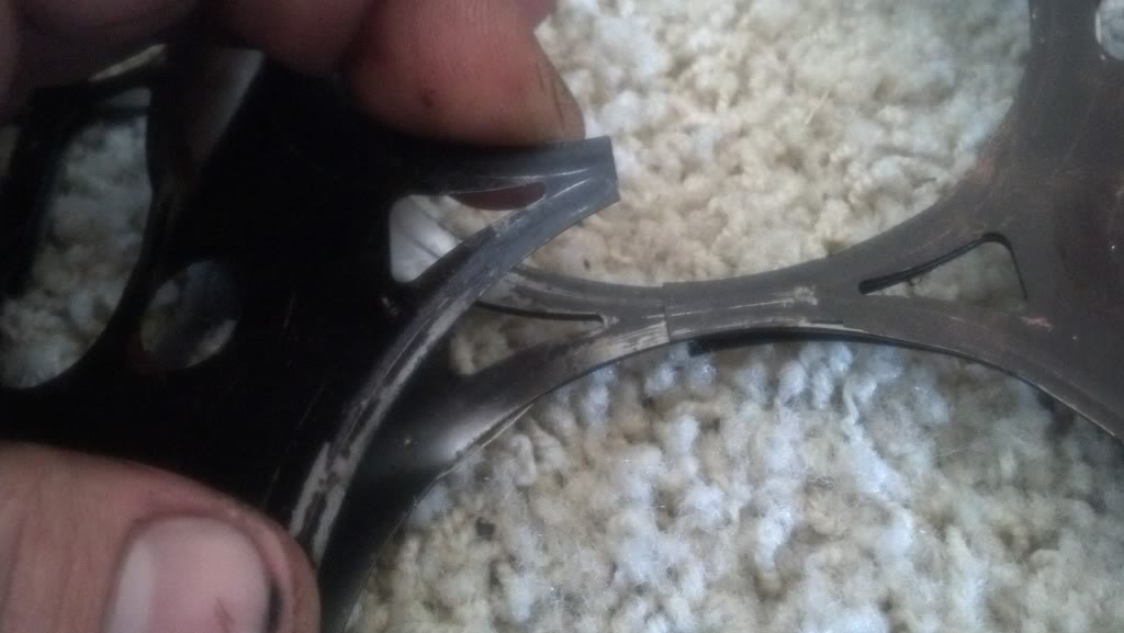

well the gasket is blown. ill post up some pics in a min.

What the heck, was that in more than one place?

Yup the crack to the water jacket was on cylinder 2, than there's a crack from 1-2 on both sides of the gasket and 2-3 on both sides. If you look close you can see the cracks under the ones I lifted in the 2nd and 3rd pic. I guess that's what I get for trying to save 20$ by buying an eBay gasket.
