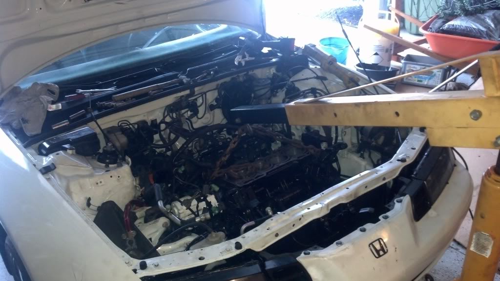

As for the car, the engines ready to pull. I have to get the hoist and stand from work tomorrow, than just pull 3 bolts and lift her out.

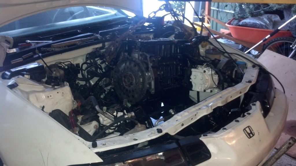

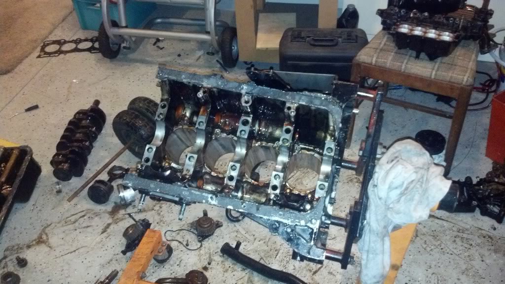

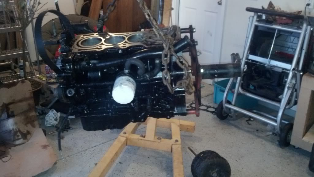

well got the engine out and the block torn down

got my block and head back today dude said he had to cut .010" off the block and .003" off the head. he also didnt hone the cylinders. he said because the cylinders are aluminum he cant hone them, something about there impregnated with silicone? idk
