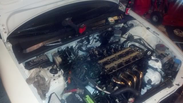

so i had to put the surging on hold because the car all of a sudden decided it didnt want to run turns out the injectors will run for a few seconds and than stop. its not the pump, i still get fuel when there not running.
anyways hopefully thats an easy fix.
heres a shot as she sits now.
