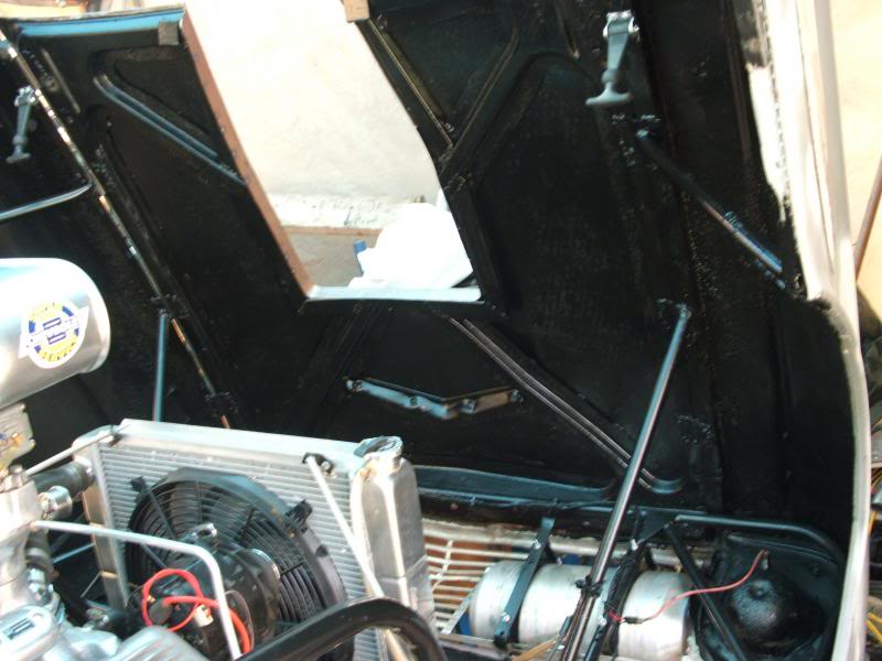

Cleaned and painted the inside of the frontend today. Wire brush, and a paint brush by hand. About 3-4 hrs. to complete it. Also added a couple extra gussets where the side supports meet the wheelwell/fender drops, just to make it better.

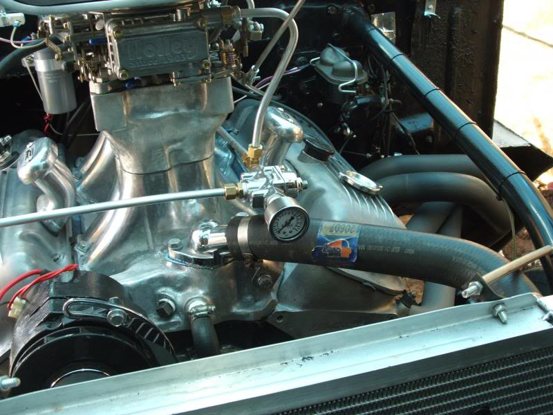

My liquid filled fuel pressure gauge came in today, and I haven't had any issues with pressure on the mechanical pump, but also had no idea where it was sitting. After installing it I found it's at just over 6 lbs. pressure, so dialed it down to 5.5 lbs.
After getting warmed up and shutting it off, the engine ran on a little, so I backed the timing off about 3 degrees, and it stopped the run on. I'm going to do a little "test and tune" tomorrow, as it's supposed to get into the 90's, and I'll find out if I need to back the timing off further if it runs too warm.
