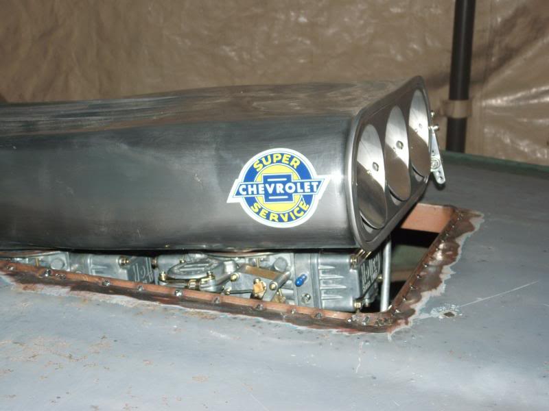

Stopped by the classic Chevy store on the way home today and got a couple classic Chevy stickers (Super Chevrolet Service) for the sides of the bug catcher. Noticed the scoop was loose, and the openings for the bases are a bit large for the Holleys. Got out the pliers and gradually bent the bottom edge in, while working my way around until the whole thing was tightened up to fit.
After getting the scoop refit, I swapped the water pump pulley for the new one. Then dug through my old scrap pile and came up with one of the heater control cables. Pulled the longest one apart and cleaned/lubed it. Then drilled a hole in the firewall and snaked it through to the carbs. Hooked it up to both carb chokes to work as a manual choke cable. Had about 1/8" left over on the length! Must be made for the Falcon's chokes!

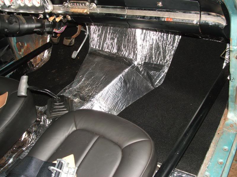

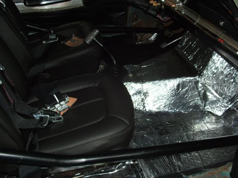

Tried out the choke system this morning while it was cool, and works great! Car only needs one start, and just adjust the choke position to keep it idling until it warms up. After warming up, I tweaked the idle mixture screws and got the engine running a bit smoother. I can hit the key now without giving it any throttle and she catches right off.
After the tuning I went to Home Depot and bought two rolls of the foil backed foam sound deadener/heat shield. The floors and firewall get pretty warm from the fenderwell headers, so I put on the insulation to try and reduce the heat. The two 15 ft. rolls did the whole floor front and back, and I found a partial roll leftover from the Austin, so I put a 2nd layer on the front to further reduce heat in the summer.
Cut up some leftover carpet from the Austin also, so I could toss it down like a floor mat to keep from screwing up the insulation until I decide what I'm doing for floor covering.
Pulled my dome light apart today, and got a replacement spring/contact piece for it. Took the guts out, and spliced in the new guts. Then wired it into a switch on the dash. The door switches on Fords aren't compatible with the grounding switch on the GM headlight switch, so had to wire it separately.
New sound/insulating material down. $39 for two rolls at HD.:
Couple pieces of old carpet for now:
