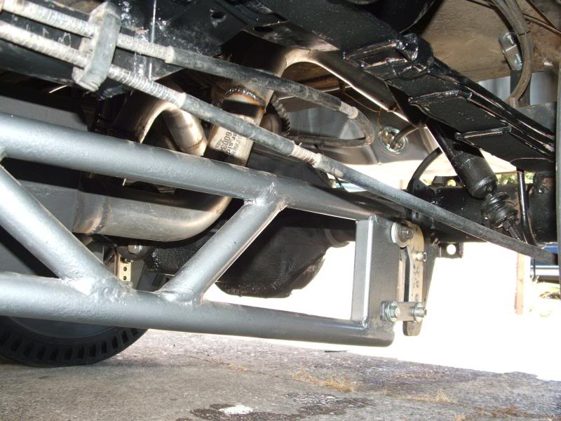

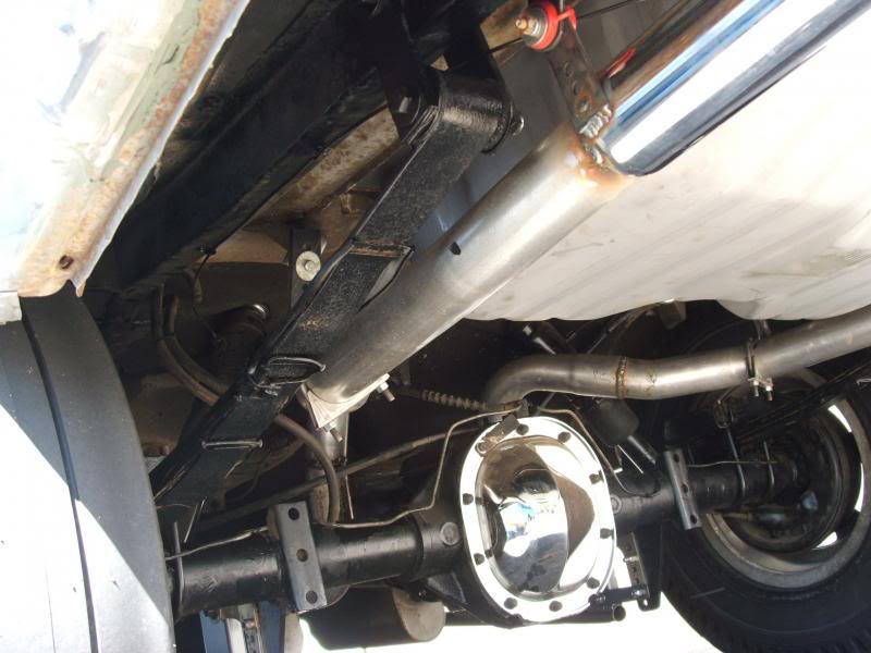

After getting the MSD back on I finally got my secondary links made for the ladder bar brackets. I had a single pivot point, and it allowed too much pinion travel before snubbing it, so wheel hop could be an issue on launch. Drove it around afterwards and it seems to allow plenty of suspension travel, and still control pinion travel.

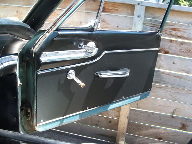

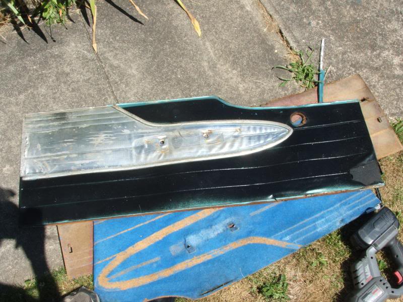

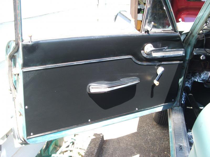

Pretty hot today, but before it got too hot I went to Home Depot and picked up my wood paneling to use for the backer on the new door panels. Also picked up a 8'x6' piece of black carpet for the floors.
Came home and removed the two nasty door panels. Pretty wrinkled, stained, and torn.
Removed the vinyl and traced the patterns on new panel, then cut it out with the jigsaw. I had lots of cheap naugahyde left over from the Austin, so I used plain black naugahyde and contact cement to cover the new panels. I'll do the backs later, as it's too warm today!
Just simple smooth black panels, with factory trim and armrests. Less than $10 per panel, and way cheaper than repops, or custom.

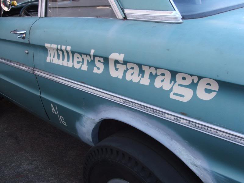

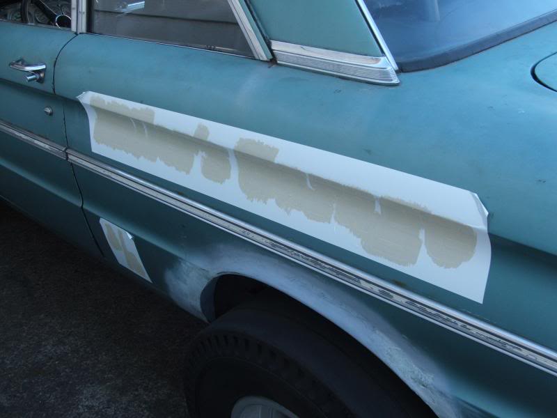

With the aid of a stencil, I brushed the lettering on the Falcon. Panted the background in yesterday.
Then did the black border this morning.
It was good practice for the 2nd set of stencils I have to do it again after new paint. Wasn't too worried about screwing this one up.
