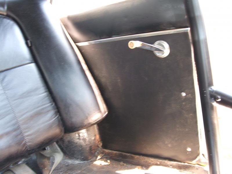

Pulled the backseat and rear side panels today. Made my templates for covering, as old panels were warped and fugly.

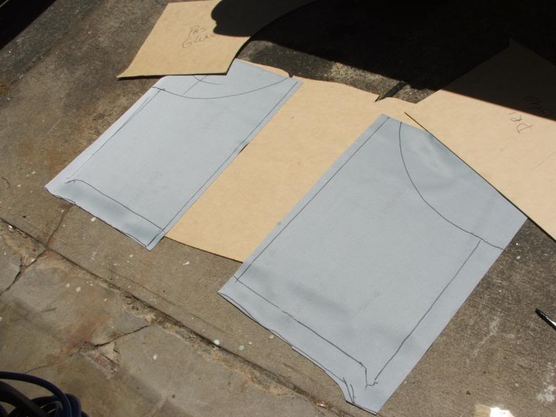

Got the naugahyde marked out, and contact cement applied to panel and vinyl.

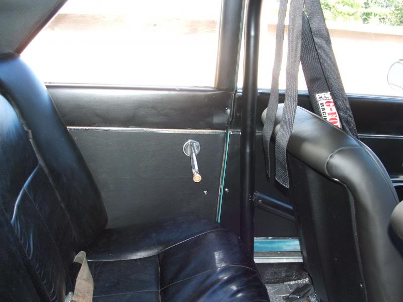

Slapped it together and installed them back on the car. Lots easier than the door panels, other than removing the seat bottom.

Just carpet left to do now, and the interior will be pretty close to done.
