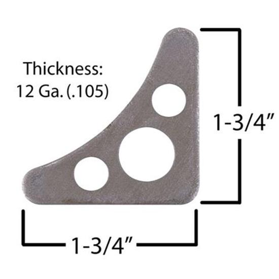

The slave piston is about 1.25" travel, and a pull type slave, so need to mount it off the frame, behind the bellhousing. I'll build up a removable bracket there, so it can be mocked up and removed for servicing the trans or clutch. I ordered some small stamped steel gussets from Speedway to use in building my bracket, and on other projects. 25 pieces for $5, and a big time saver vs. making them up.
