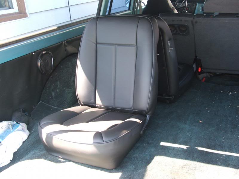

On the way home I stopped and picked up my recovered MII bucket seats. Had him delete the headrest openings, and sew them to match the Taurus backseat pattern. They came out very nice, but the material is just a bit less shiny than the rear seat. I may wipe it down with some Armorall to see if it brings up some sheen to match closer.

Got the seats back in the car, and got back on wiring. Instrument panel is done, as are the tailights. Officially christened the Falcon in blood today when I tested a new razor knife blade on my thumb while trying to remove the cloth outter sheath on the old wiring loom. Got it taped up, and finished up the rear wiring. Need to get a battery soon, so I can test ckts. I was going to do it before I soldered and heat shrunk the connections, but forgot. Hope it's all good, and don't need to cut the splices out!

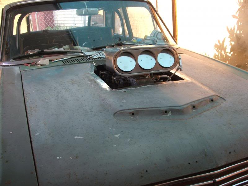

Finally sucked it up and got brave. I welded my support in on the underside of the hood, and cut out the hole. Haven't set it on the car yet to check fit, and still needs to be trimmed out once I get an idea where it needs it.

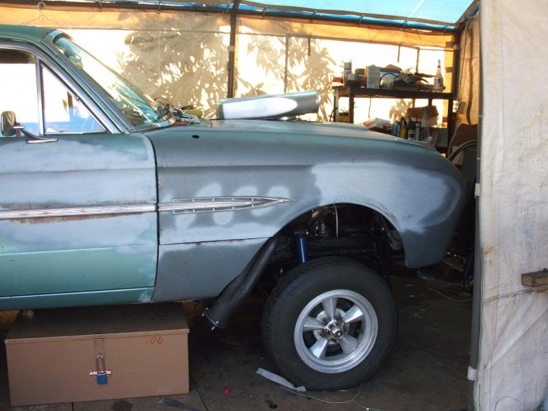

Had my neighbor come over and help me set the frontend back on so I could check the fit. Even after opeing up the rear edge wider toaccomodate the pivot forward, it still rubs on the scoop when I tilt. I need to open the tapered rear section another .5"-1" on each side. Might just take the last couple inches straight back to clear better.
Got more wiring done up front to connect the headlights, and install my QD plugs for headlights and turnsignals. Also got my battery cables all made up and installed. Stopped byy my old workplace to borrow a Greenlee crimper for the lugs on the cable, and they grabbed one out of a bin of about 50 of them. I looked at the number on it, and it turned out to have my van number on it from the first new van the company bought me in 1991! Tool guy laughed and said, "It must want to stay with you, so I wont check it out of inventory!" Looks like I've got a crimper for the next time now!
Cranked the engine over after wiring the battery, and battery cutoff switch, and set all the valves. I can install the plugs and wires, and finish up under the dash now. Tried for an hour to figure out the wiper wiring, and never got them to budge. Guess I'll do without wipers until I figure out the wires on the factory plug.
