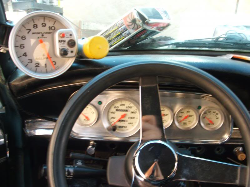

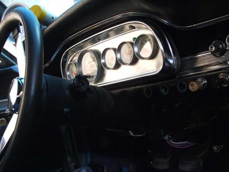

I am such a dope. I put the new ignition sw. on the column today, and still wouldn't turn the starter. After pulling the old sw. apart to see how the contacts make up, I realised I had two wires transposed when I pinned the new connector! Swapped the hot with one accessory wire and it worked fine. So it seems the Camaro switch is smarter than the guy doing the wiring!
Got the gauges hooked up, and gauge panel back in. Still have to dress the wires down under the dash and hood. Also have to get chrome filler plugs for empty holes in the lower dash, and plugs for some firewall holes. Goofed off this morning and spent half a day with old friends at lunch.

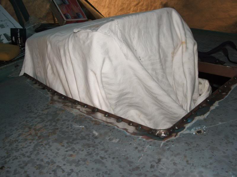

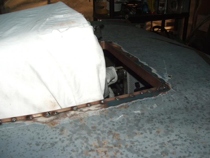

After the pedal I had a little time left, so I got the edging that's bent 1/4" to 110 degrees, and fitted it to the hood opening, so the raw edge wont keep catching my gloves or the old sheet I have on the motor. Had to cut about an inch out of the two 90 degree corners to allow it to bend and then make up fillers to weld back in on the corners. Just tacked for now, but it came out OK, and stiffened up the tilt frontend too. It gives the opening a raised lip also, to look better.
