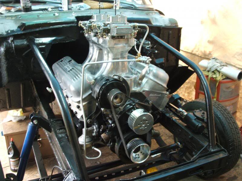

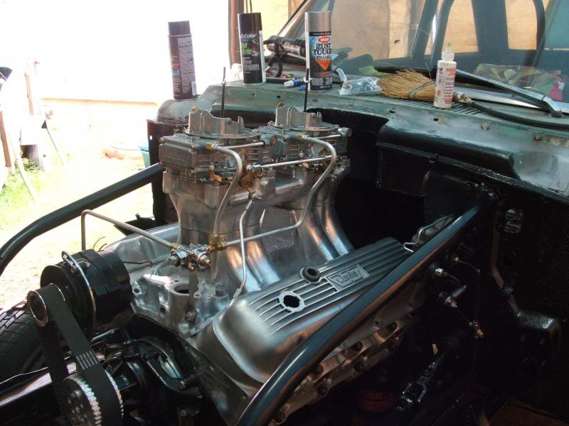

I think I'll stick with what I have!
Dropped the engine back in the chassis today. Set the intake on and bent up my fuel lines. Built a support for regulator, but still need to fab one for the long line from pump to regulator.
Had a minor screw up when I primed the oil system, and didn't realise the sending unit was loose. Pumped 2-3 qys. of Brad Penn oil on the floor before I saw it running out! What a mess! $20 down the drain too!
