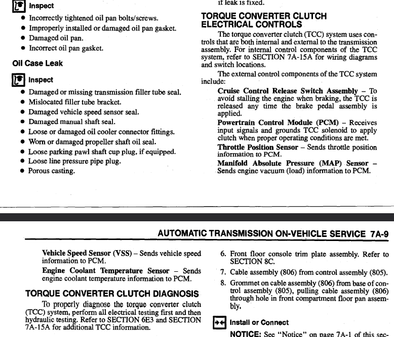

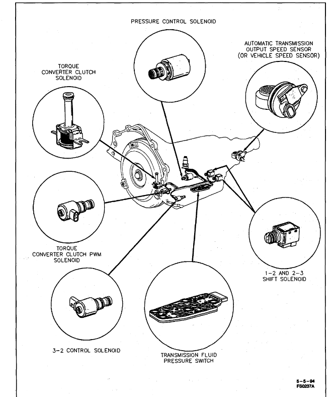

My last ditch effort b4 replacing converter will be replacing PWM solenoid, TCC solenoid & all the others since I'm in there of course. The service manual excerpt pic below says to check TPS and other electronic parts first. My tranny shifts very smoovely through ALL gears so I don't know if replacing the coolant sensor & the others would help in my case. I don't even think the solenoid replacements will help but the TCC PWM & the other TCC solenoid failure symptoms sound more relevant to me.
Thoughts on both TCC solenoids fixing shudder? Also, the solenoid kits make $ sense but should I stick with ACDelco or is there a decent non-OEM kit I can use?
