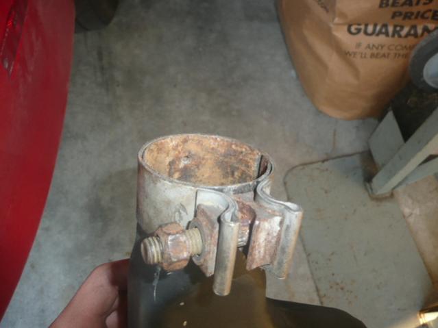

ill post a picture when the camera charges. another thing is can i drive with the cross plate after the one that holds the tranny? the oem exhaust clamp for the s pipe to the i pipe was no good so i had to use a clamp the 2 bolts but it does not clear the plate and it resting ageist it and making noise. and where can i buy a belt style clamp like the oem one?

the first picture is the plate in the exhaust, the second one is the clamp i need and the third is the brace i want to take off intell i get a proper clamp on there.

From that photo, you don't have the S-Pipe fully inserted -- it should go mostly unto that raised section, plus that bolt needs to align through the hole in the plate. For clamps, most auto places sell them like Summit, WS6store, ThunderRacing, Jegs, etc.

should i take the plate out or leave it? would it be effecting performance at all? and i cant align the bolt because the other side hits the brace and it rattles and annoys me. I just want to remove the brace until i get the right clamp but i dont know if that will harm anything. also could i put something on the exhaust pipe to get it to push on more? me and my dad where pushing and twisting and wiggling and thats all we could get.

Disconnect the rest of the exhaust and get the S-pipe in the way it should be first, THEN connect the rest, else you may have an exhaust leak...
