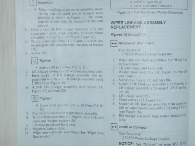

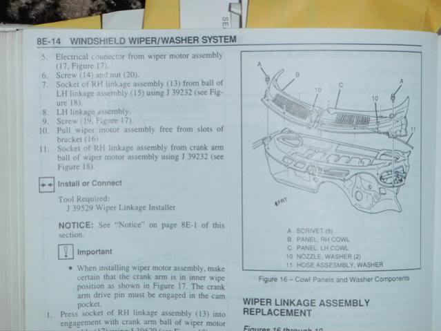

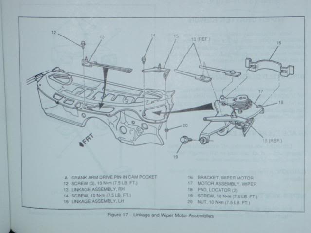

So I've got this problem with my windshield wipers, it seems one of the bolts holding the motor down has mysteriously fell out causing a loud clunking noise from the cowl. I need to know what is the easiest way to get to the motor? I've tried only taking the plastic cover off but my hands are far too big to get in the area. How do you do it?
