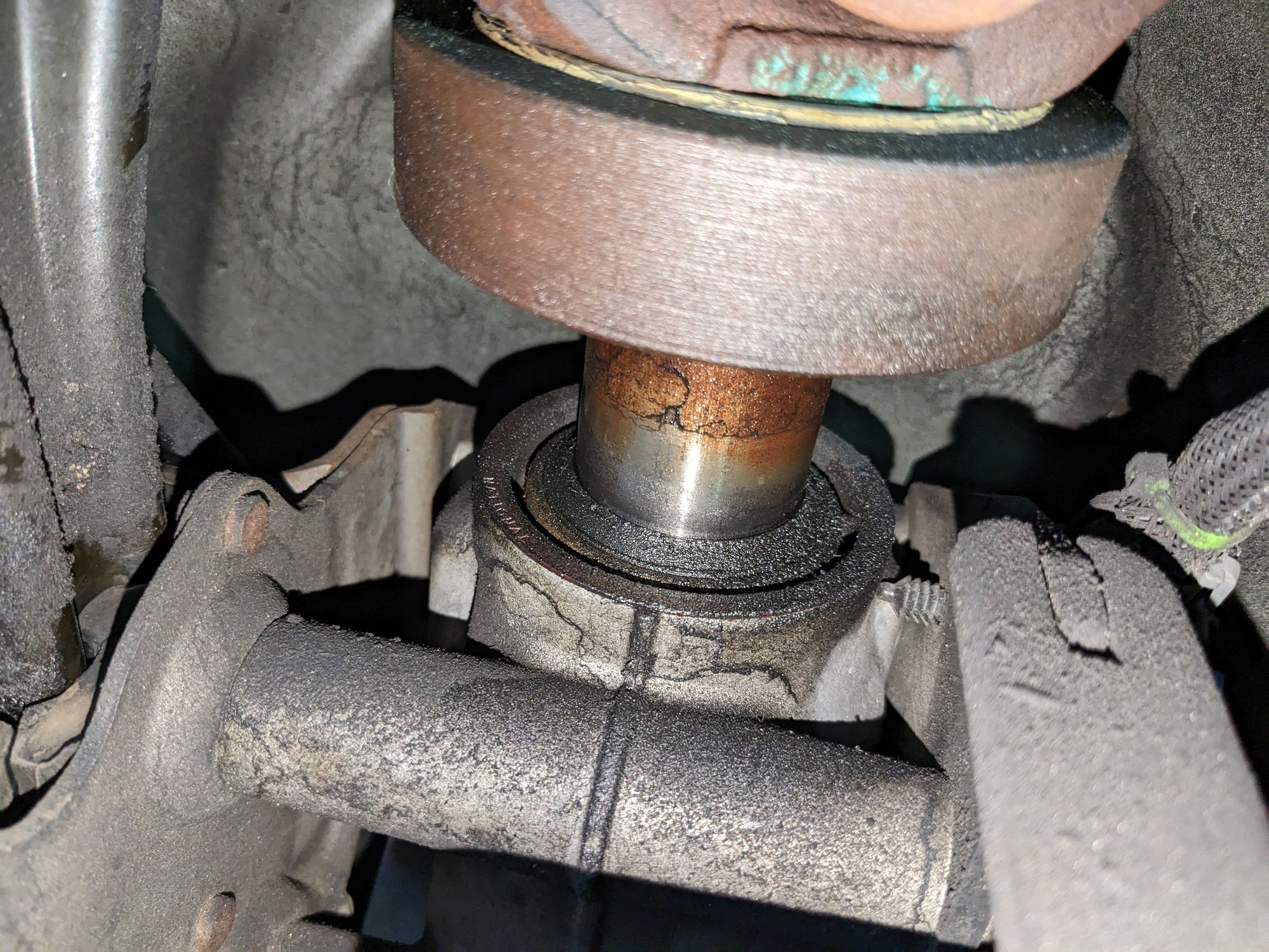

@Gorn the seals at both ends of the driveshaft are leaking,
At the input shaft, where it connects to the transfer case at the front, and the pinion seal at the differential in the rear.
I don't have any differential noise, I'm not sure how we got to that topic.
My noise issue is a bad wheel/axle bearing on rear passenger side. I have to drain the diff to change both axle bearings and seals.
What I was questioning was if the diff should be drained for the pinion seal replacement.
It would be counter-productive to drain the diff, fix the axles, refill the diff...then a week later, pull the driveshaft to replace the seals, only to find that I need to drain the diff again for the pinion seal. I'm only asking because I cannot physically do the axles and the driveshaft seals on the same day.

You can change the pinion seal while you have it drained. and if you have the drive shaft out you might as well do the slip yoke seal in the back of the transmission.
