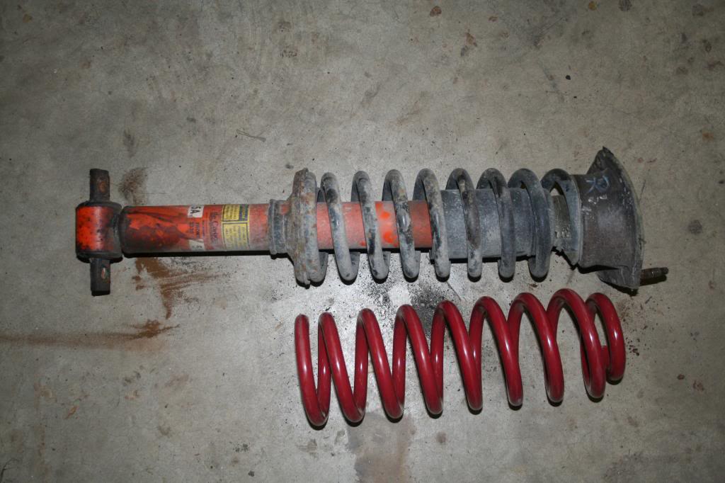

Thats cool. I just go by what rock auto /gm parts direct tells me I need for the front, which is a strut....It's inside the coil spring, so do you need a strut compressor to remove it.....or not? Can you replace it without dissassembly of the unit?
Old Mar 19, 2013 | 09:38 AM
Randy Bilyea's Avatar
Joined: Sep 2012
Posts: 146
From: SW Ontario, Canada

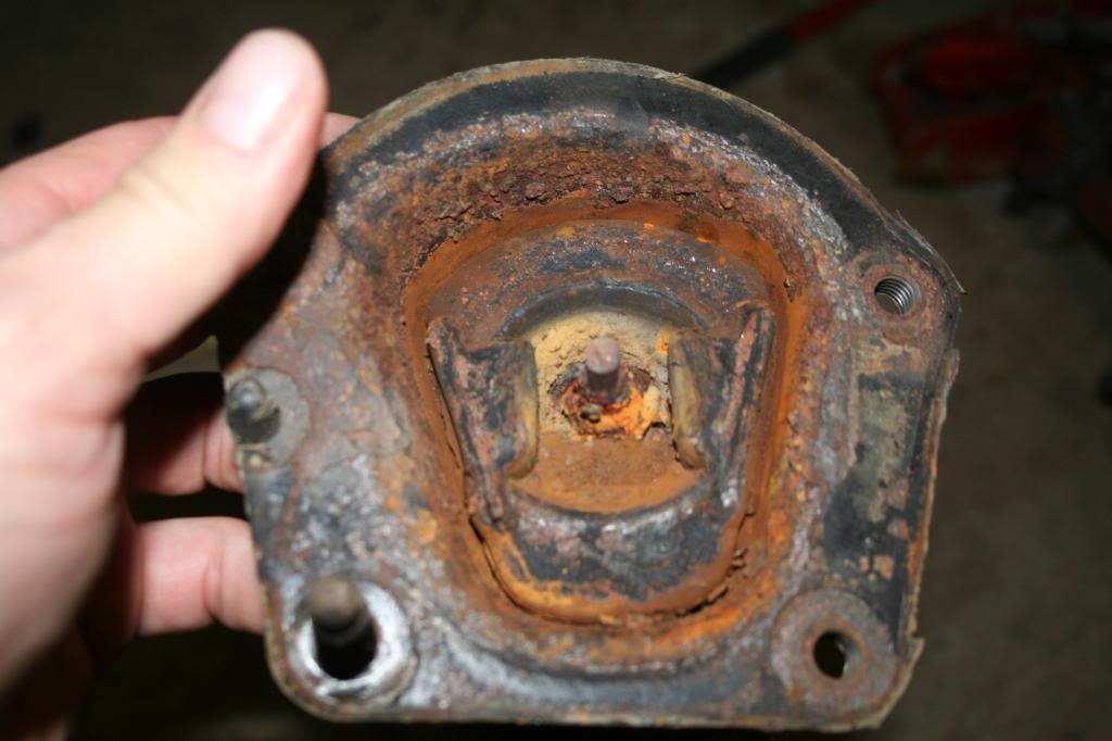

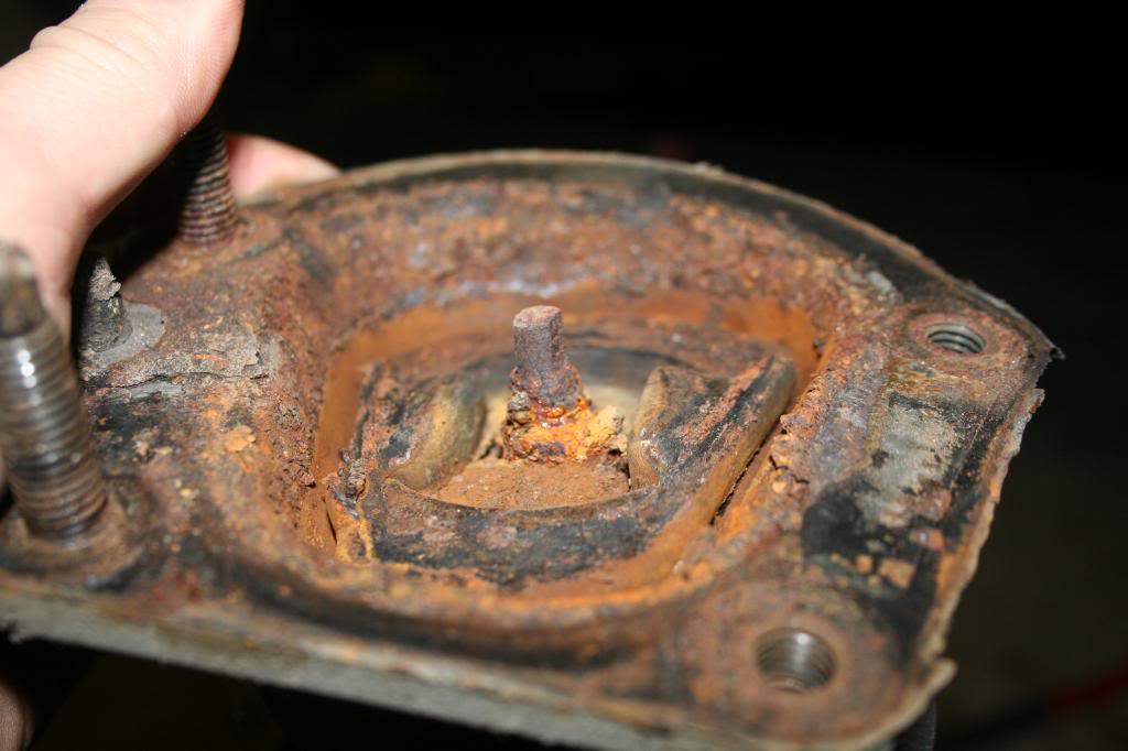

You will require a spring compressor to remove the fronts, preferably wall mounted.
As shown below, you will probably end up torching the upper nut off, needing a mount for each side as well.
If you are getting new springs too, just take the old assemblies out and toss in the dumpster. Install the new springs, mounts on to the new shocks and re-install.
It's what I had to do. I was changing springs anyway though.
