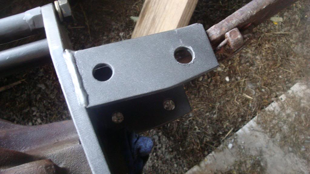

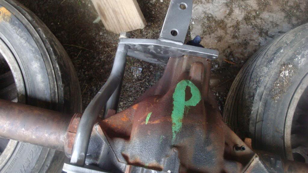

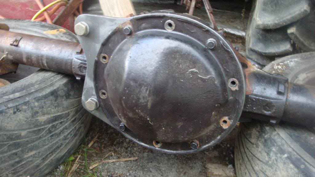

Been meaning to get these up but between working full time, trying to get estimates of the damage to the car, and trying to figure out what broke on my four wheeler, it's been hard to find time to do anything really that I want too. But this thing is solid and feel it'll do quite fine with the power I'll put down.

I realize this moves the torque arm mount forward a few inches from the original location, so I plan on using this from BMR.

Interesting torque arm mount on the rear pumpkin. Is that a tried and tested design?
Curious how the small bolts that were only designed to hold on a tin cover will hold up against the torque that's trying to lift the whole front of the car?

It's based off the GNx design, so it should be. But we'll find out soon enough.
The bolts for the cover have to replaced because the originals are too short with the added thickness of the mount. Four (maybe six) will be replaced with studs, the others with the grade 8 bolts that I have now. I also be replacing the stock cover with a girdle, so that should help some too.

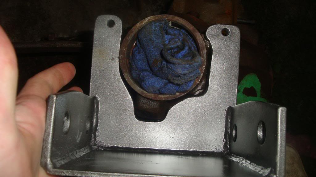

The front part sits snug (actually too snug, gonna have to grind a wee bit down) and there's another plate that bolts to connect the bottom and top of it.
For what I need it for, I feel it'll do more than enough. If it breaks though, I do have a few other back up ideas for a mount.

Yeah, the one thing I see is the lifting force would want to rotate that pinion plate (since it isn't "attached" to the housing), bottom towards the back & top towards the front, to where it could push back on the lower bar that attaches to the cover plate. More force will be pushing against the bottom cover bolts since that's where the outward pressure will be applied.

I see what you're saying, but the front of the mount wraps around the differential housing and prevents it from lifting. I'll show you a pic of what I mean. But I tried lifting just the mount with one arm while pushing down on the housing with the other (I know not near close to the same amount of force as launching the car) but even with one of the bars not bolted down and attachment plate not attached it hardly moved.

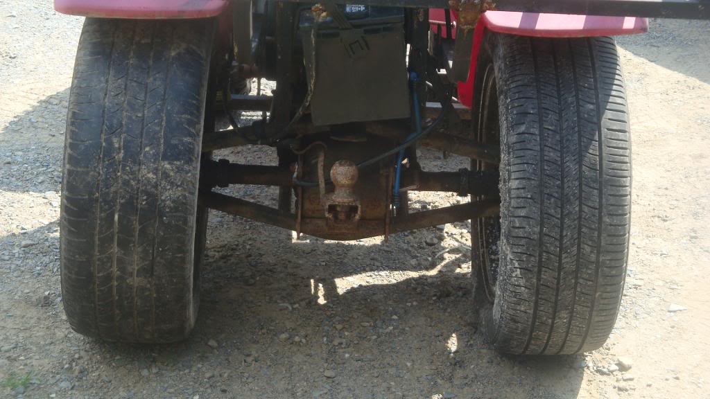

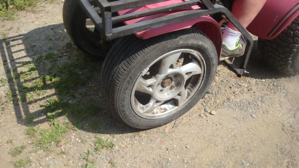

Also, here's something for your enjoyment. Had this four wheeler I've been trying to get running for my little sister. Well it had a flat tire which didn't make it safely drivable. Noticed today that it had a five lug bolt pattern and just thought what the hell, I have some 5 lug wheels lying around, I'll see if they fit. And what do you know? Perfect fit! One wheel is off my brothers old Grand Am and the other off a Alero (same bolt pattern). My buddy Jimmy tested it first to see if it was safe.

lmao thats pretty good, now try the atv tires on the car.
