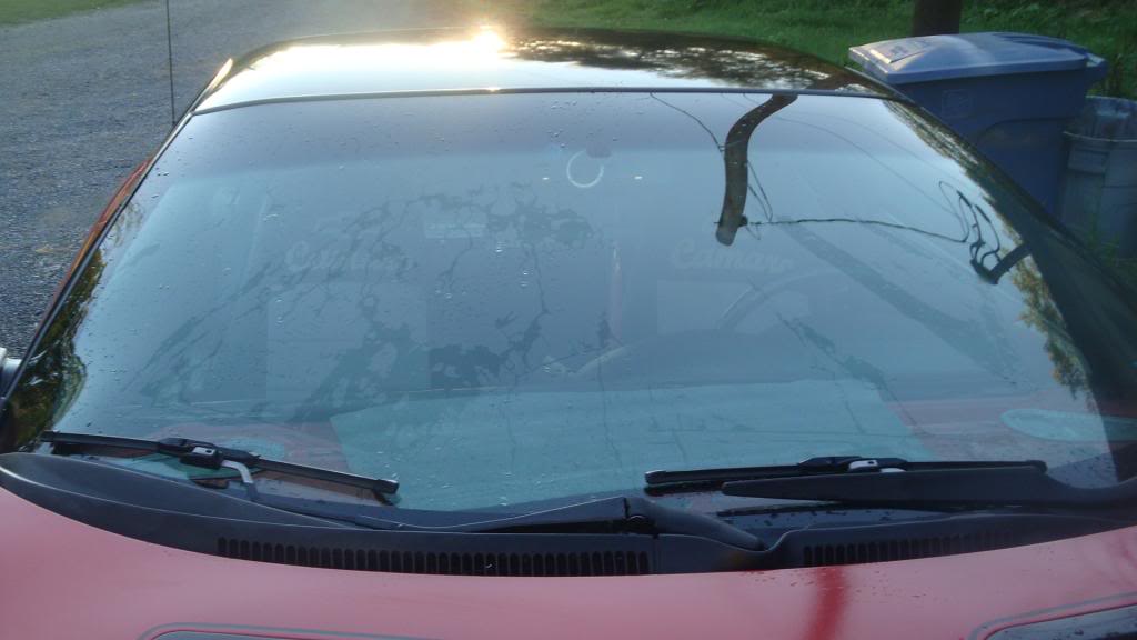

Finally got the windshield replaced!
I had SafeLite replace it for me. Ran $338 but they were the cheapest in my area and they did it while I was at work. The guy (Kevin) was awesome and knew exactly what he was doing because he has been doing it for 26 years, has done the fourth gen before AND he owns a '95 Camaro! He said it's only the V6, but he has fun with it. But he had my window out and replaced in probably 20 minutes. He jokingly said mine was real easy because he didn't have to worry about cracking the dash (cause I don't have one, haha). But I'm glad its replaced. Car looks much, much better.

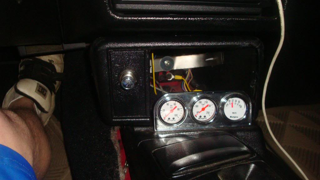

I also managed to get my power outlet and gauge cover partially installed. Not finished yet. Still gotta make a plate to hide all the wiring.

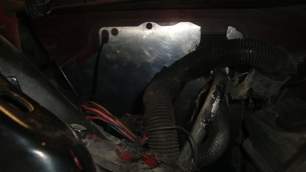

But any ways, block off plate came in the other day. Already got it in! Needed some trimming since I'm retaining heat and because technically it's supposed to go on the inside of the firewall, but I didn't wanna tear my whole dash just for that. There's some other mods that need done so heat can easily flow through the heater core, but for now, I'm just glad the hole is covered!

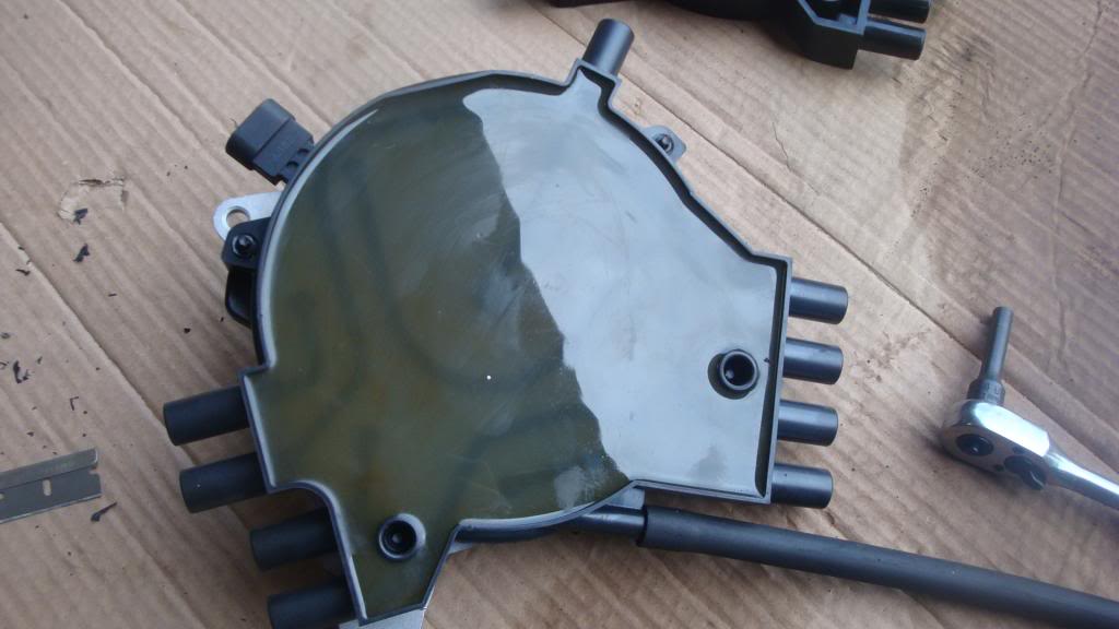

So I finally got around to changing the Opti since I think that's what may have been causing my problems. While I was at it, I went ahead and modded it a little so may be I'll get more than a year out of it. Any ways, I bought a cap from the 95+ years and replaced the stock cap with it and than ran a vacuum line up to the intake tube. Went to fire it up and she started so fast it made my dad stop working on his wheels. I barely turned the key and she was running. Any ways, here's a pic of the modded Opti.

That was step one, you missed step two. You needed to modify the body of the opti as well, so you have good air flowing through it. Just hooking up to the cap hose isn't going to help, and you actually made it worse because now dirty air will be drawn into the bottom vent holes, to muck up the optics and contacts. Read this article, for when the new opti fails: Opti-Spark Options
