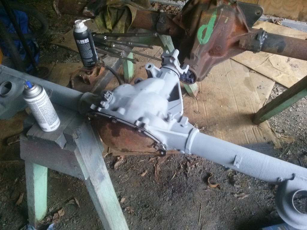

I finally broke down and bought another rear end. Local salvage yard wanted $325 for used, 3.42 LSD rear! I told them too much and drove 60 miles to a U-pull it yard that charges $100 for any rear end. Only one I found was a LSD but it was hit hard in the rear so instead of chancing having a bent axle tube, I went back to the local salvage yard and haggled a little on the price. I ended up paying $265 with tax for a 3.42 LSD, still too much in my book, but I wanna get the car to the track and those 2.73s just weren't gonna cut it!

New rear is primered!
Actually, it's painted too, but I apparently forgot to get a pic of that. It'll be in the car tomorrow. Shouldn't have any trouble since the all the bolts with the exception of the torque arm a brand new.

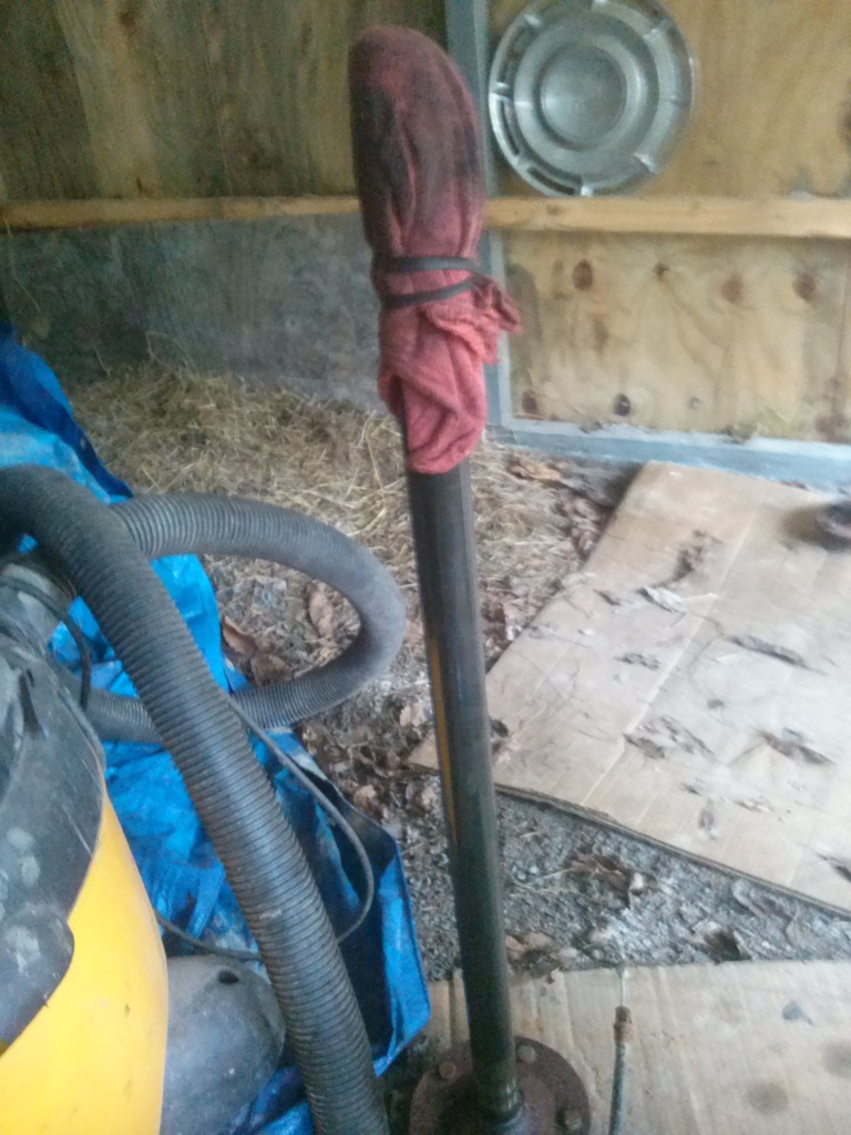

I'm sure I'm not the first, but came up with an easy way to clean the axle tubes.

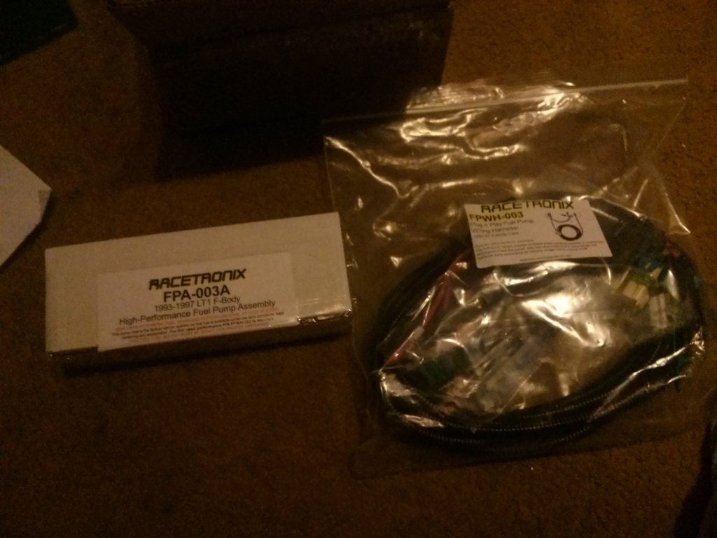

Got a present from UPS. RaceTronix fuel pump and wiring harness kit. I honestly don't need it yet, but planning for the future. Next on the list is going to be O2 conversion kit to swap over the heated sensors, which hopefully cures my misfire problem, since it came back. Trans will need replaced soon. 2nd gear is slowly on it's way out.
Pic!
