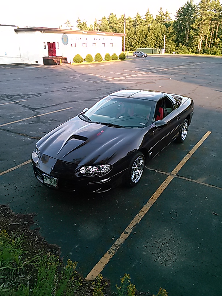

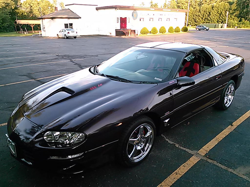

sometimes i like to remind myself where i came from 2 front ends an 2 engines an a straight car still better then before stronger faster 99.9% rust free near 11years now i have owned it .will be 23 next april back to the car ,did new plugs ,found out i had no real pcv valve back to paper gas filter there better then glass,going to do shocks front ball joints Aug ,got new panhard bar traction bars all with greace fitings car drives so much better should drive like new soon an handle nice ,then going to put the .cherry bombs in it for this year bump stops few other things rear end cover an fluid change ,next year cast aluminum valve covers comeing.
