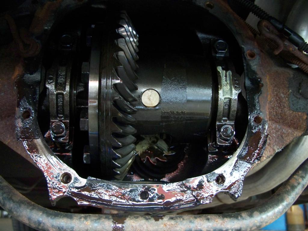

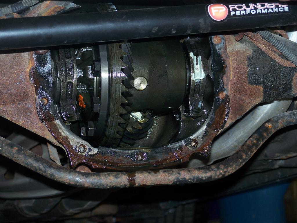

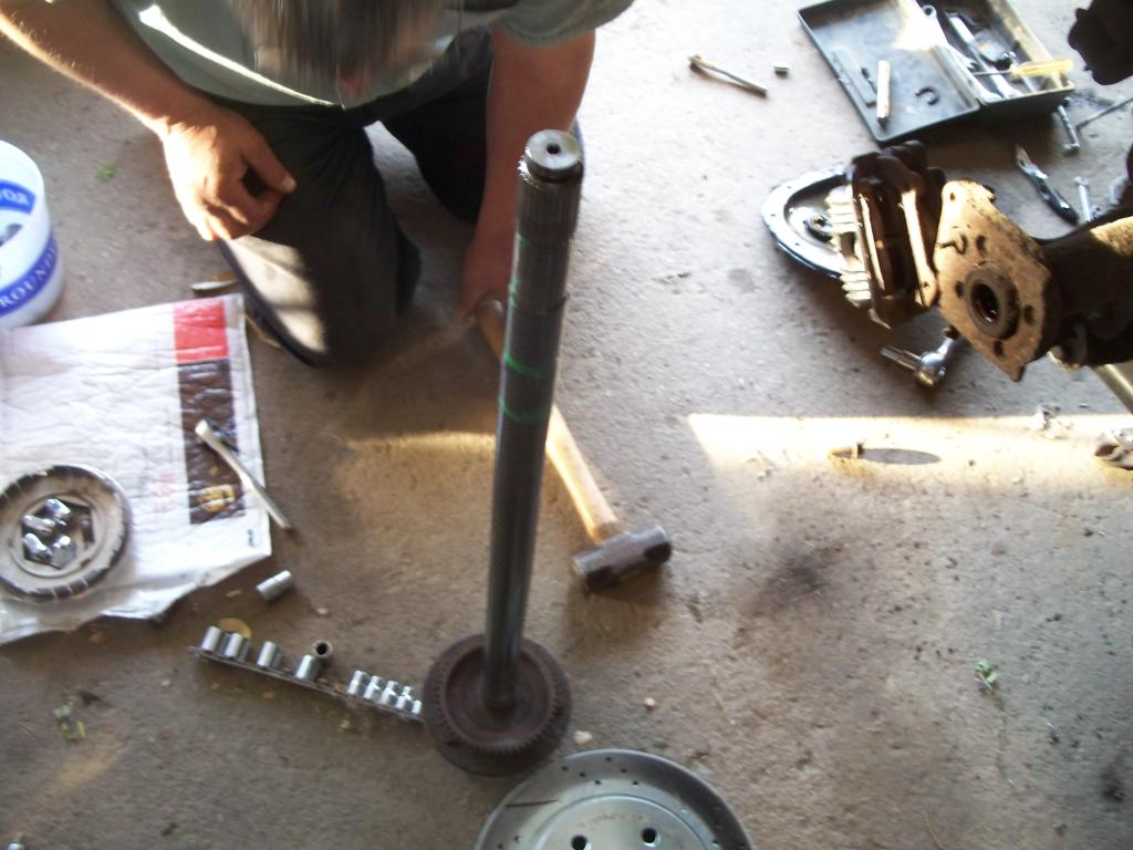

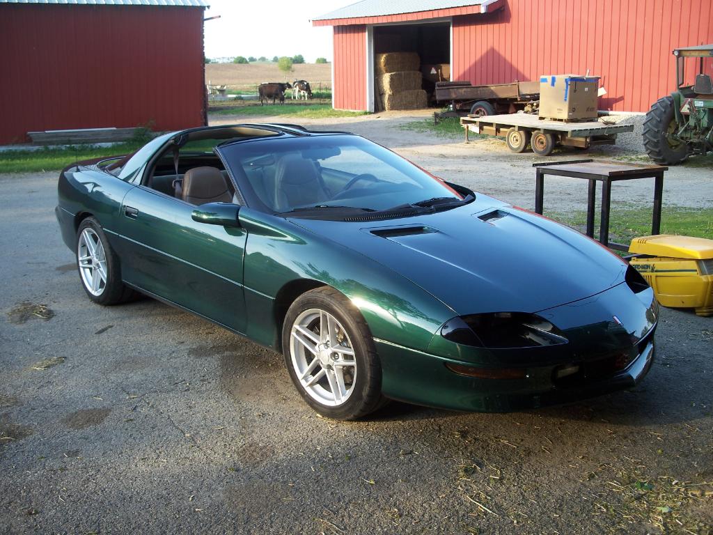

Sorry for the lack of updates, I've been to busy actually working on the car haha. As you well know, I had to take apart the rear axle to change the bad lugs. But Scooch, your wait is finally over
After a lot of annoyance, we finally got the rear axle out:

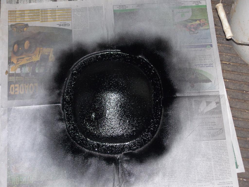

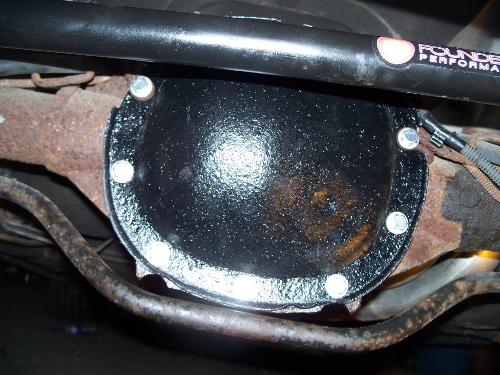

Figured as long as the diff cover is off, I might as well paint it:

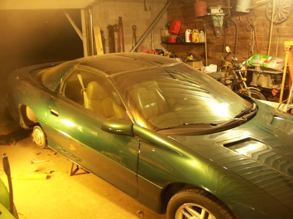

Here's a peek of how I've been working:

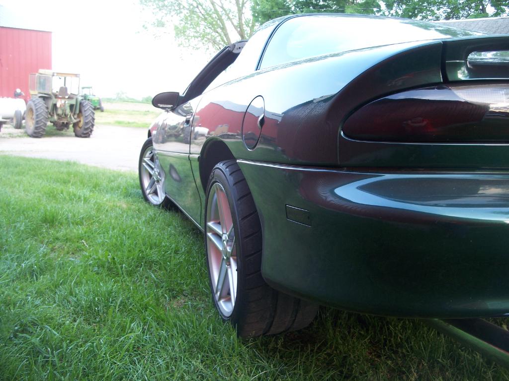

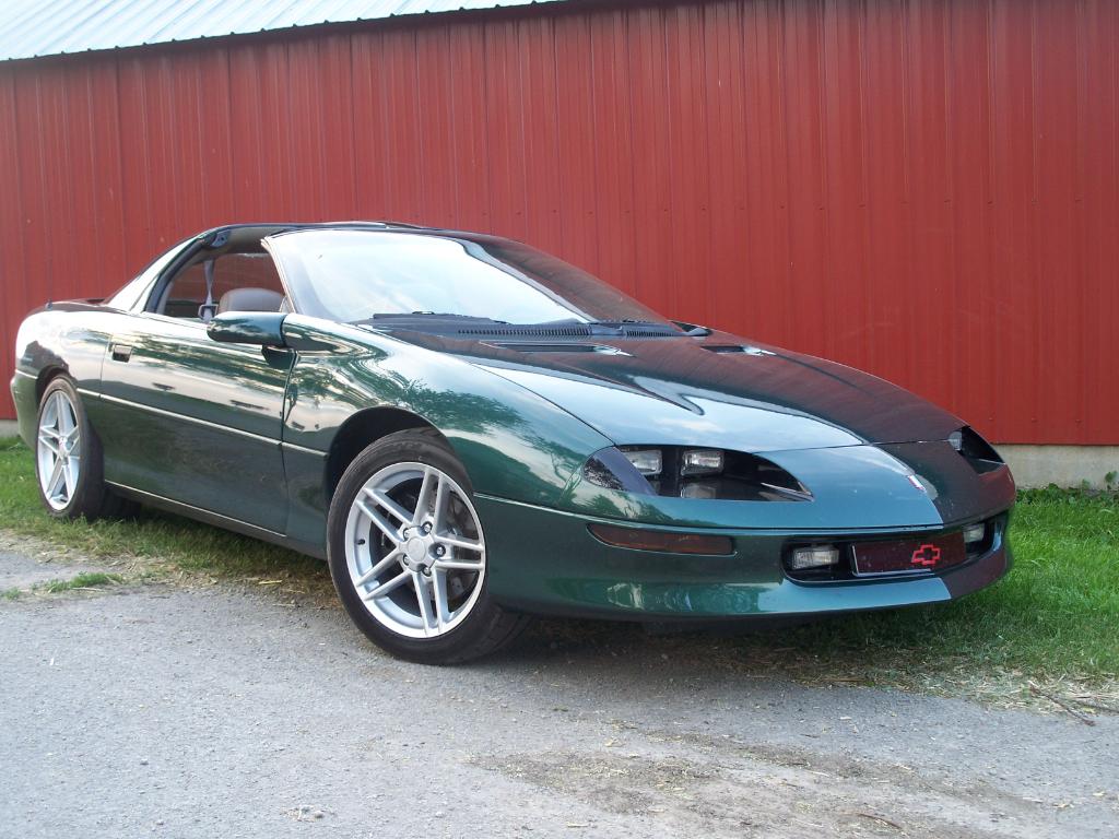

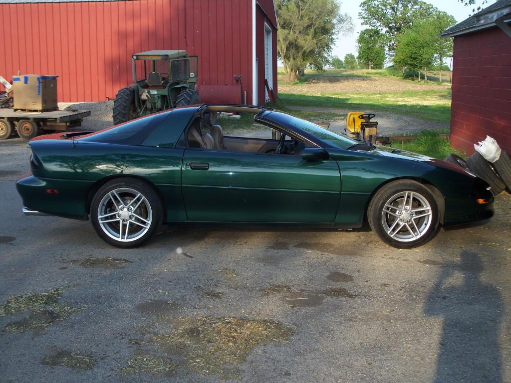

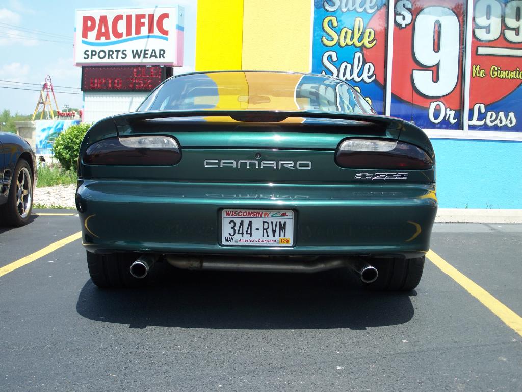

And finally, the rims. Let me tell you, the rears were a HUGE pain in the ****. First of all, the center opening wasn't big enough to go around the hub decent. It's as though it was manufactured to the right clearance, but the addition of the paint made it so the rim wouldn't go on decent. I sure hope I don't have to remove them anytime soon, because they ain't coming off easy. At one point I took the lugs back off to try to take the wheel off, and I had to stand up and kick it really hard to get it off...and it wasn't even on all the way. I also had to mess with the adjustable panhard to make sure I had clearance for the 295s on both sides. I thought I had the rear centered, but apparently I didn't. But anyway, I eventually did get the rims installed and I washed up the car to get to Automotion in Wisconsin Dells today, so here are some pics from that:

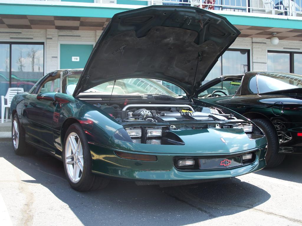

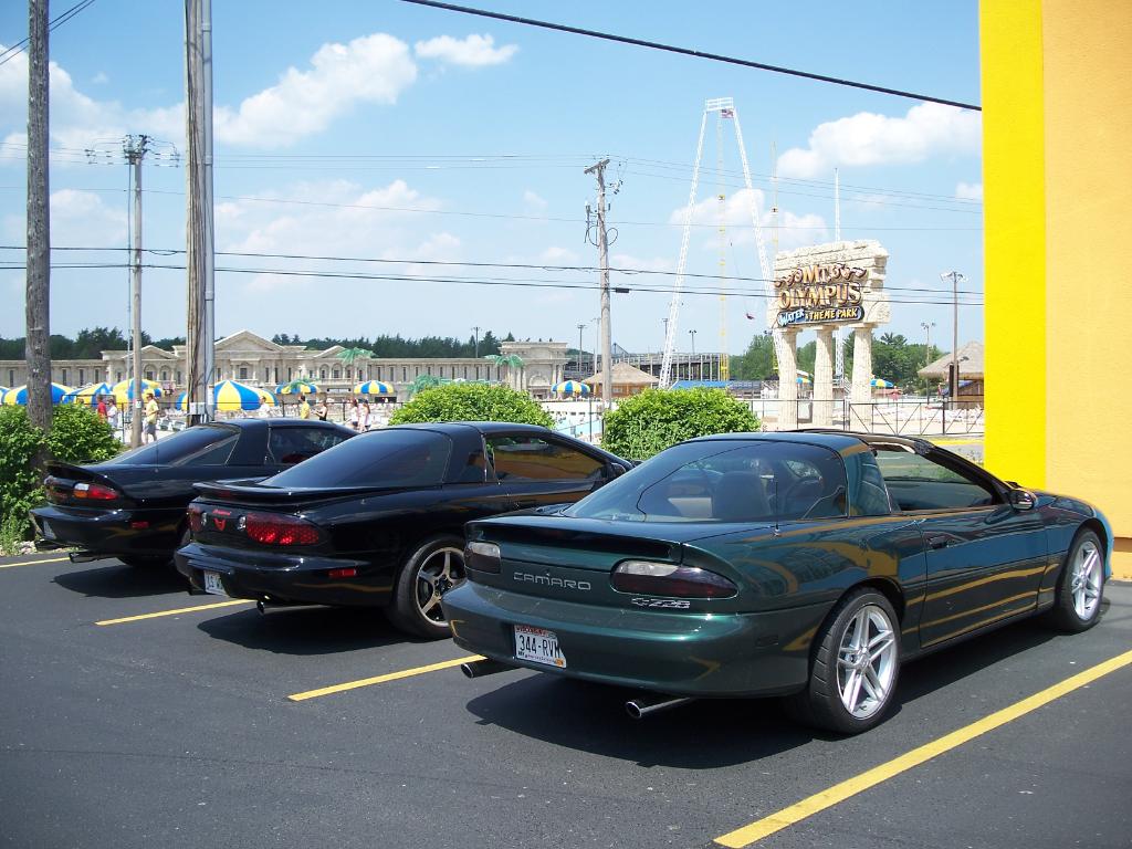

First, I parked by a couple fellow F-bodies

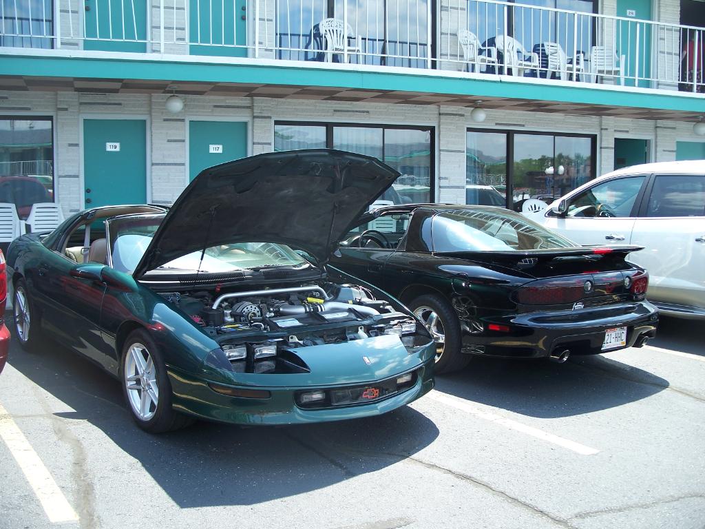

changed location, again parking next to a fellow F-Body:

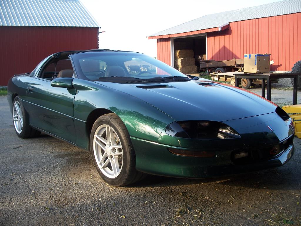

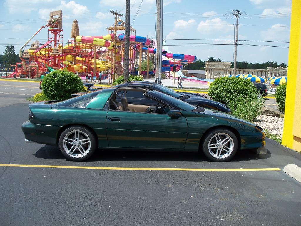

When I got home:
Wheels are C6 Z06 replicas from OEwheels LLC. 17x9.5 front, 18x10.5 rear. Wrapped in Nitto NT05 rubber. 275/40-17 front and 295/35-18 rear.
