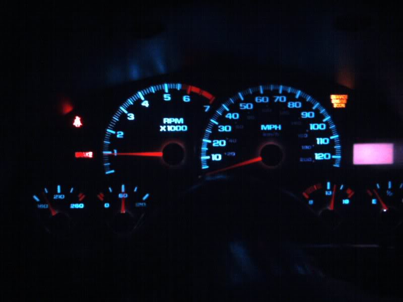

There's no weak spots. My cluster looks perfect. The other bulbs are for the high beam light, and turn signals and I don't remember what else is in there. Having those as LEDs are ungodly obnoxious. Therefore, not necessary. So 5 is just fine. Keep in mind though, putting white LEDs in there will look blue unless you get a custom cluster and HVAC set made. Which is very expensive.
This is an older pic with the different LEDs in, but the new ones still look about the same. I haven't taken any pics of the new ones and HVAC set.
HVACs are not the same. They are 2 smaller 74 bulbs. They require being broken out. The lighting control....I haven't gotten to yet. That's not easy to do and requires a single led bulb (the one with the neg and pos pins) and soldering back together. I have my HVACS changed to LEDs because they burnt out. My lighting control hasn't been changed. I want to grab one from the junk yard and pull apart. If you do it wrong, you can destroy the unit. Very tricky.
