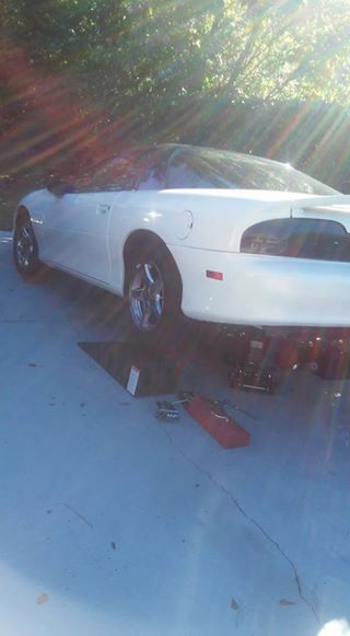

Here's a picture, somewhat.
Father decided to go ahead and just drop the drive shaft out, and drop it off at the machine shop while he's got it torn-down interior wise right now.
