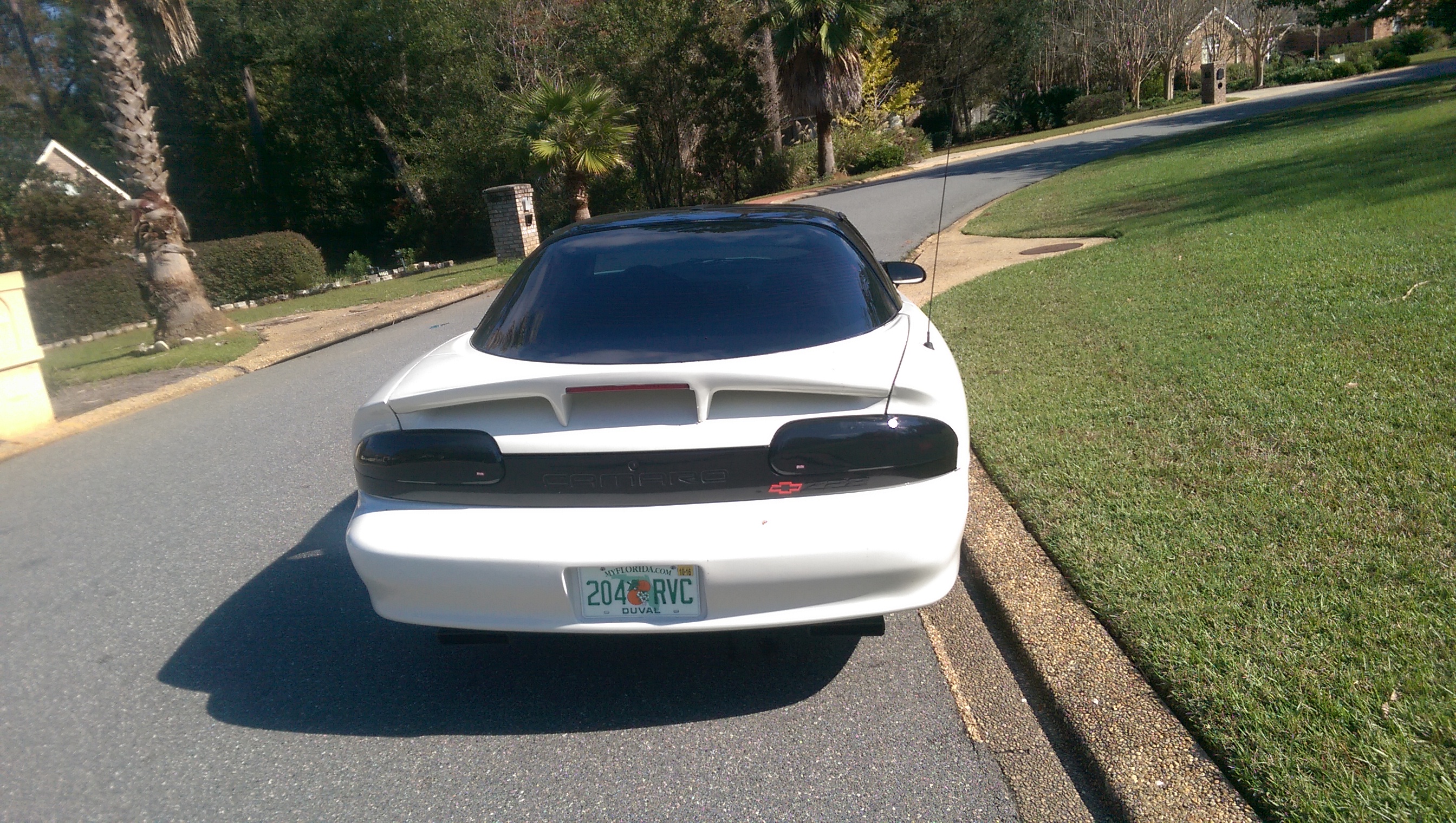

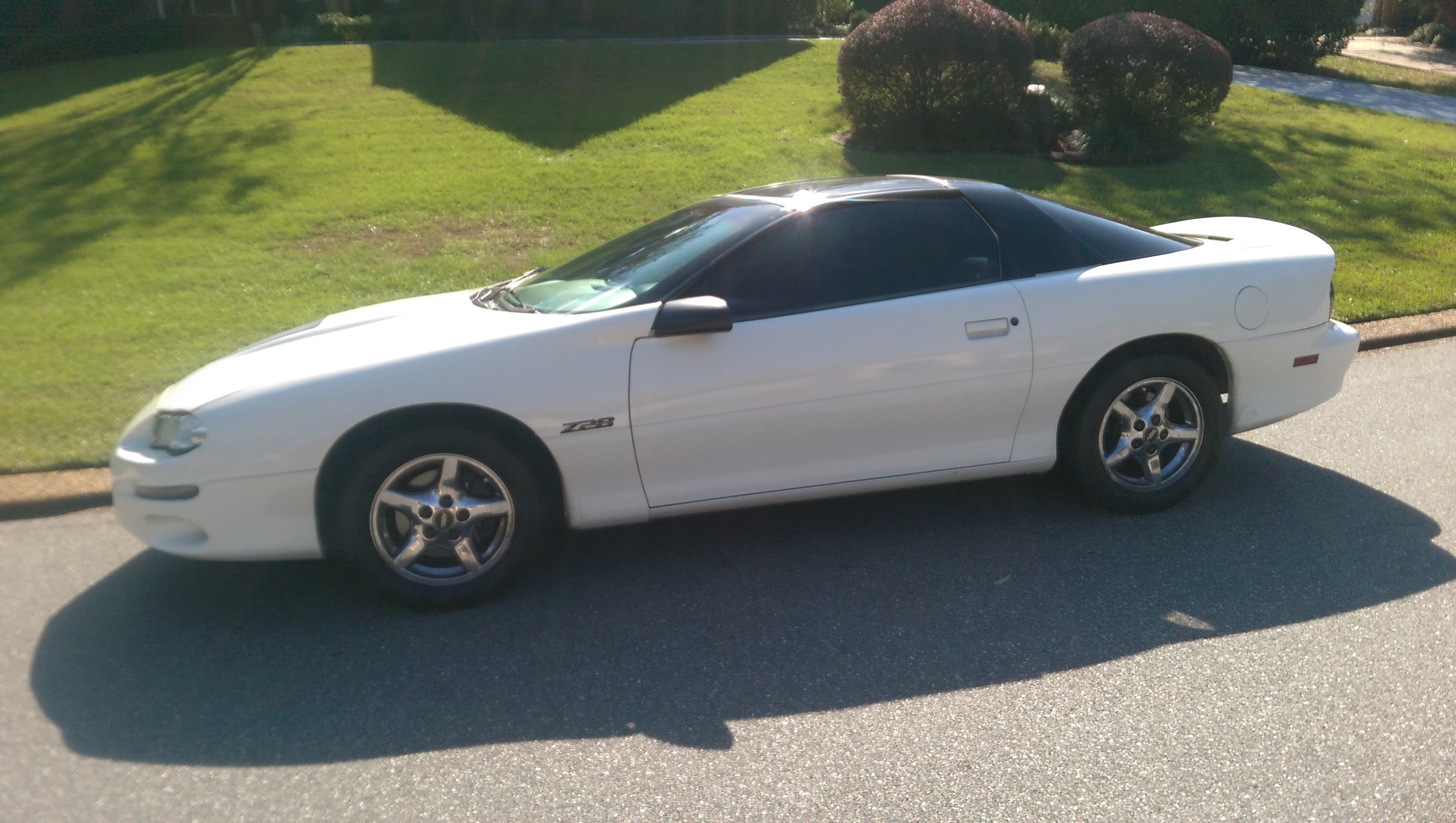

Pictures.
Attached Thumbnails Updates and records of my car.-imag0258.jpg   Updates and records of my car.-imag0259.jpg   Updates and records of my car.-imag0260.jpg   Updates and records of my car.-imag0261.jpg
Old Nov 23, 2015 | 11:23 AM
  #69
95 camaro 406's Avatar
Joined: Aug 2014
Posts: 2,315
From: troy NH
nice pictures got an ss hood ,I would just rebuild it with you father ,its hard to find rebuilt rearends out there for these cars ,I am hopeing I can get bye with rebuild kit an new 3.42 gears bearings ,new yokes ,I seen the kit that comes with the bearings seal kit ring an pinion like $200.00 then another 200,00 if you feel you need new axels ,
