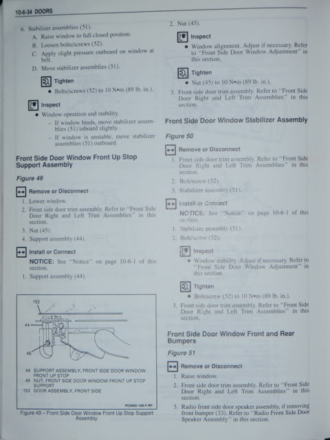

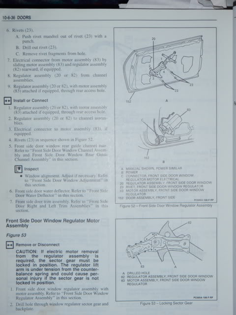

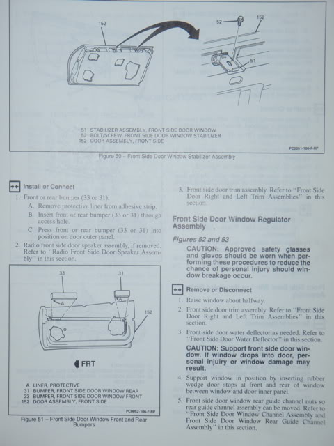

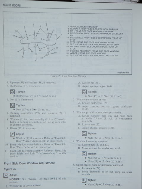

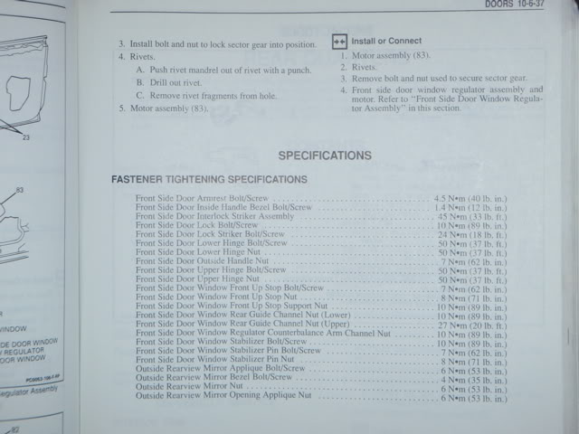

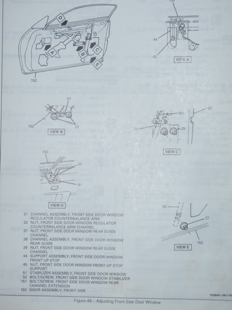

dont get the cheap china crab motor, you ll be replacing in a short time. use oem motor if you can find one.
