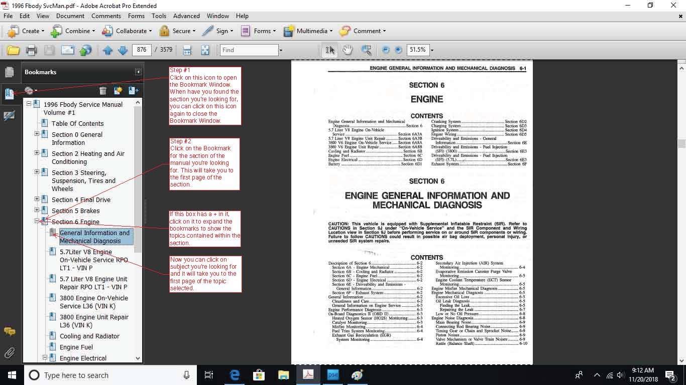

Do you know how to use the bookmarks of an Acrobat document? The copy of the service manual you can download from this site should be setup with them. The picture below should explain how to use them. Section 8 gives a written description of the ground locations beginning on page 8A-14-16. This should also give a reference for sectional view to help identify it.

ok, I have the manual in pdf but I am viewing it thru the browser and not Acrobat.
I'm sorry, I forgot to mention you would have to an Acrobat Reader program to use the bookmarks.
