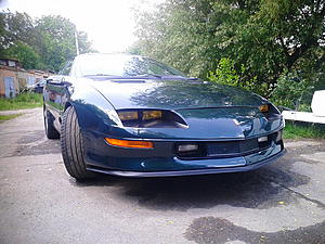

As, I myself consider the ABS codes on the camaro shawl 1996. 3.4 V6. Diagnostic connection of OBD 2, but protocol OBD1.
