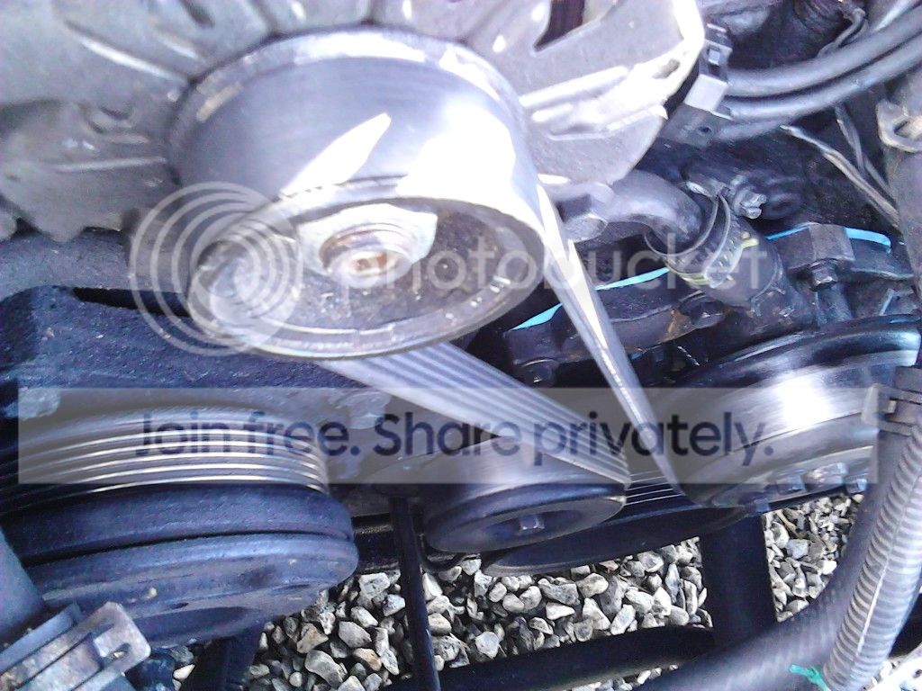

Strange reaction to the tensioner, I wouldn't have expected that. The picture makes it look like there was a decent amount of deflection to the belt from the tensioner. Or was that an optical illusion?
Haha! Apparently it was an optical illusion. It did seem fine at first, but thats the results. Im not sure how that happened to the tensioner, but I can even have my girlfriend who worked with me on this vouch. It took both of my arm strength to get that thing down before we put the shorter belt on, and now she can just lean on it after we took it off. If anyone can describe how this happened, that would be awesome. Id like to know the actual physics behind the reason why.

Only thing that can make sense to me is you over-extended the spring beyond it's designed boing-back state. Kinda like how constantly jumping an off-road truck can remove the tension on the suspension springs faster than when being road driven.
Glad you at least did this test. Now we can refer others to this thread should they have the same hair-brained idea!

Yea, I think you make a valid point there. Its just too much consistent tension. And Iim glad too. I like being taught and therefore teaching. This should be sticky, you know how much research I did and came across nothing of this idea. haha

Hey! I was about to post the picture up. HAHA. Anyhow, I kept all my a/c stuff since I will want it in the summer. If anyone does want to know the belt number, just message me. Ii kept the box for future reference. If you want a video showing no issues as well, I can do that. Bbut for now, here is my picture. Again, I had to take the picture on an angle, so you cant see just how much curve and tension is on it. But like I said, the angle is enough combined with the direction of spin from the torque that it will push down the tensioner and not slip.
