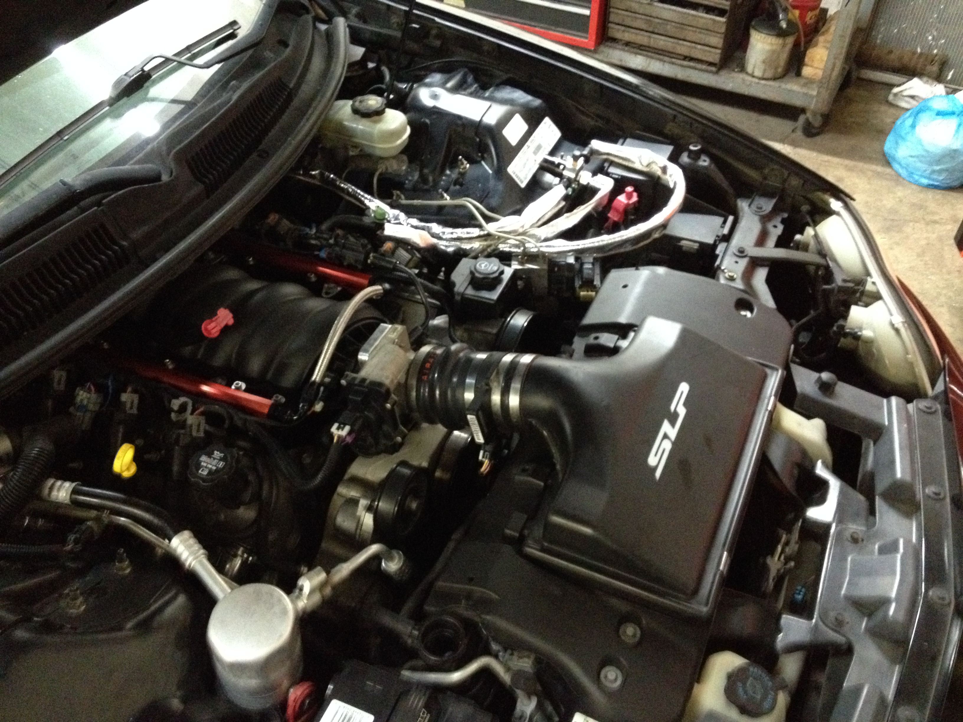

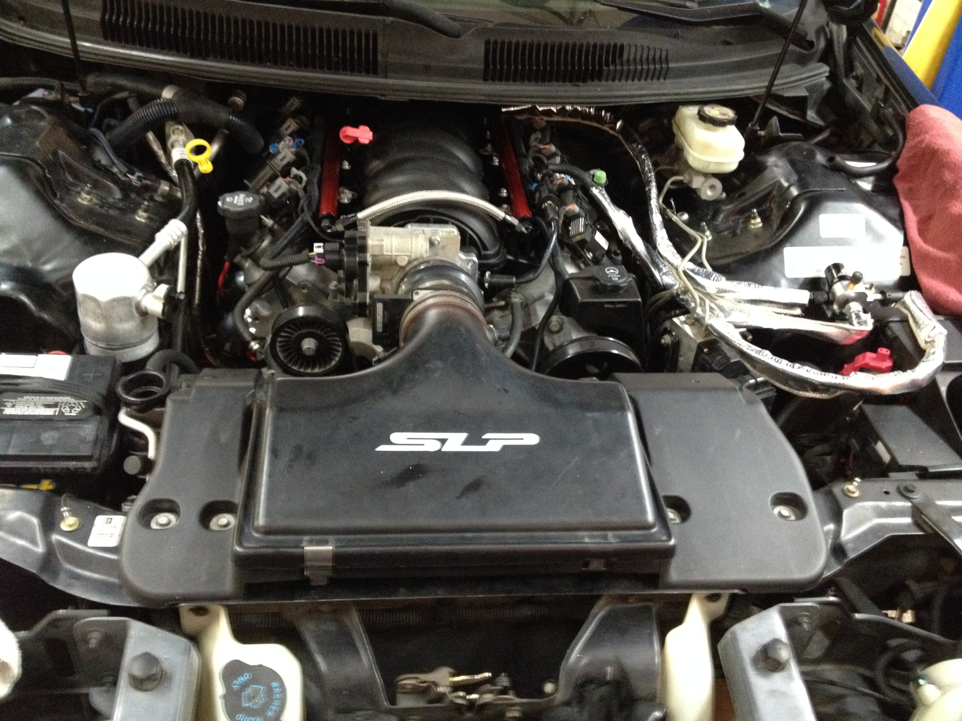

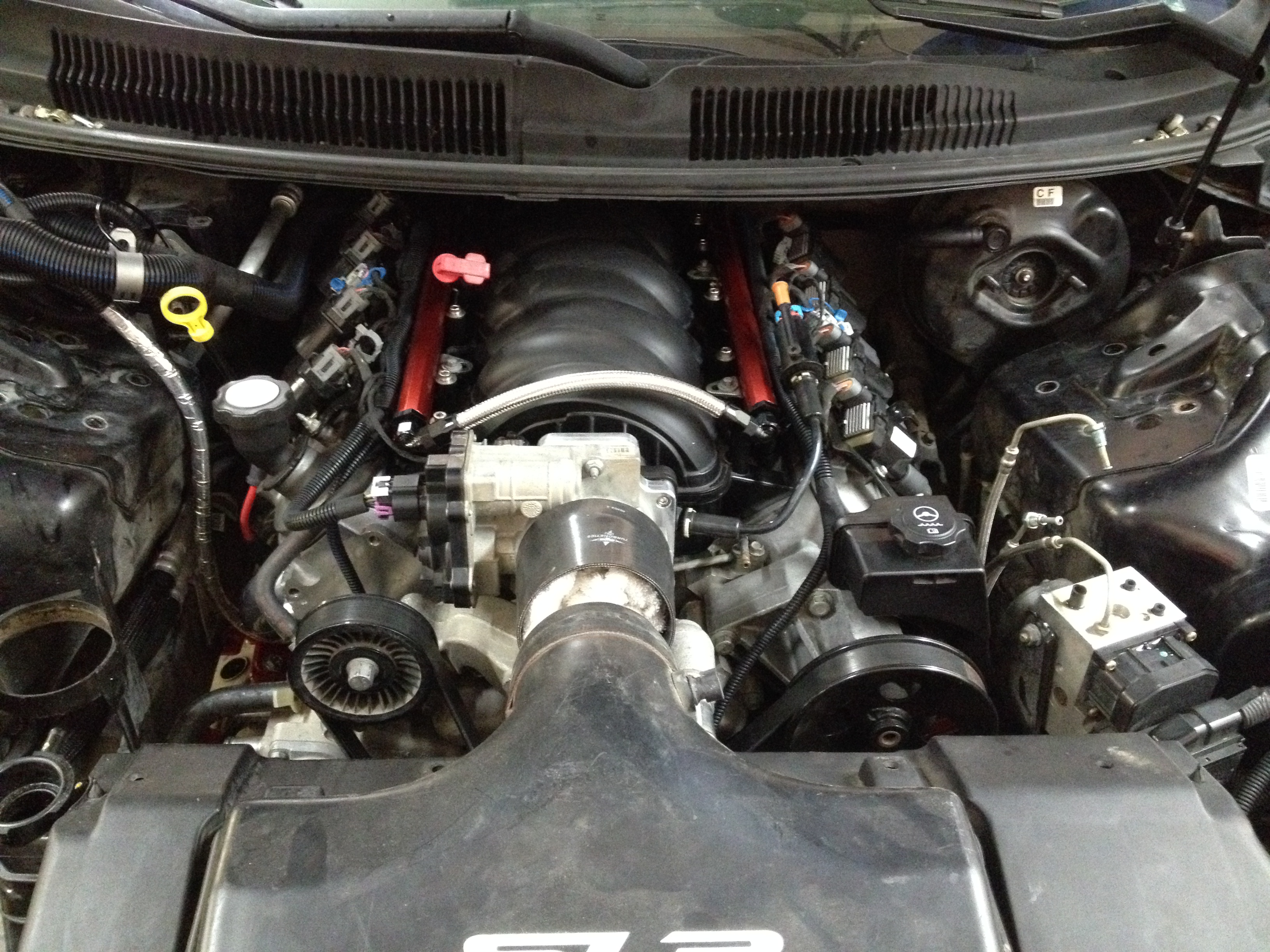

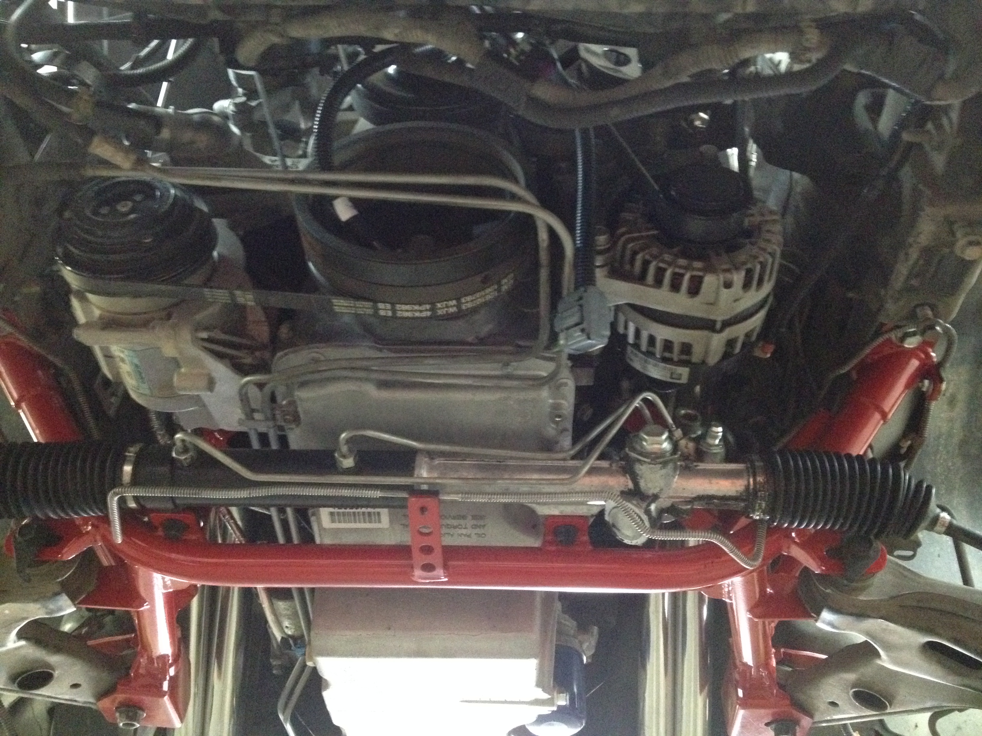

Getting really close guys!!!!!!
Engine/Transmission are in, Power Steering lines done, New Radiator, Flushed the Evaporator & Condenser, Rerouted the battery cables to the Starter & Alternator (Shorten the Starter cable, Lengthen the Alternator cable), Y-pipe & Exhaust, A stock LS1 lower radiator hose fits, Fuel system done, Front Brakes, Timken wheel bearings, Bilstein Struts, New upper control arm bushings.
Still need to do...
AC hoses
Air intake
Evap line
Mount/Modify the Truck DBW gas pedal
Change the fuel filter
Wire cruise control
Rear shocks
Upper radiator hose
Alignment
Get new tires mounted & balanced
Waiting on PCM from the Tuner
Attached Thumbnails '01 Camaro V6 to V8 swap.-camero-engine-042.jpg   '01 Camaro V6 to V8 swap.-camero-engine-028.jpg   '01 Camaro V6 to V8 swap.-camero-engine-iphone-068.jpg   '01 Camaro V6 to V8 swap.-camero-engine-iphone-060.jpg   '01 Camaro V6 to V8 swap.-camero-engine-iphone-026.jpg

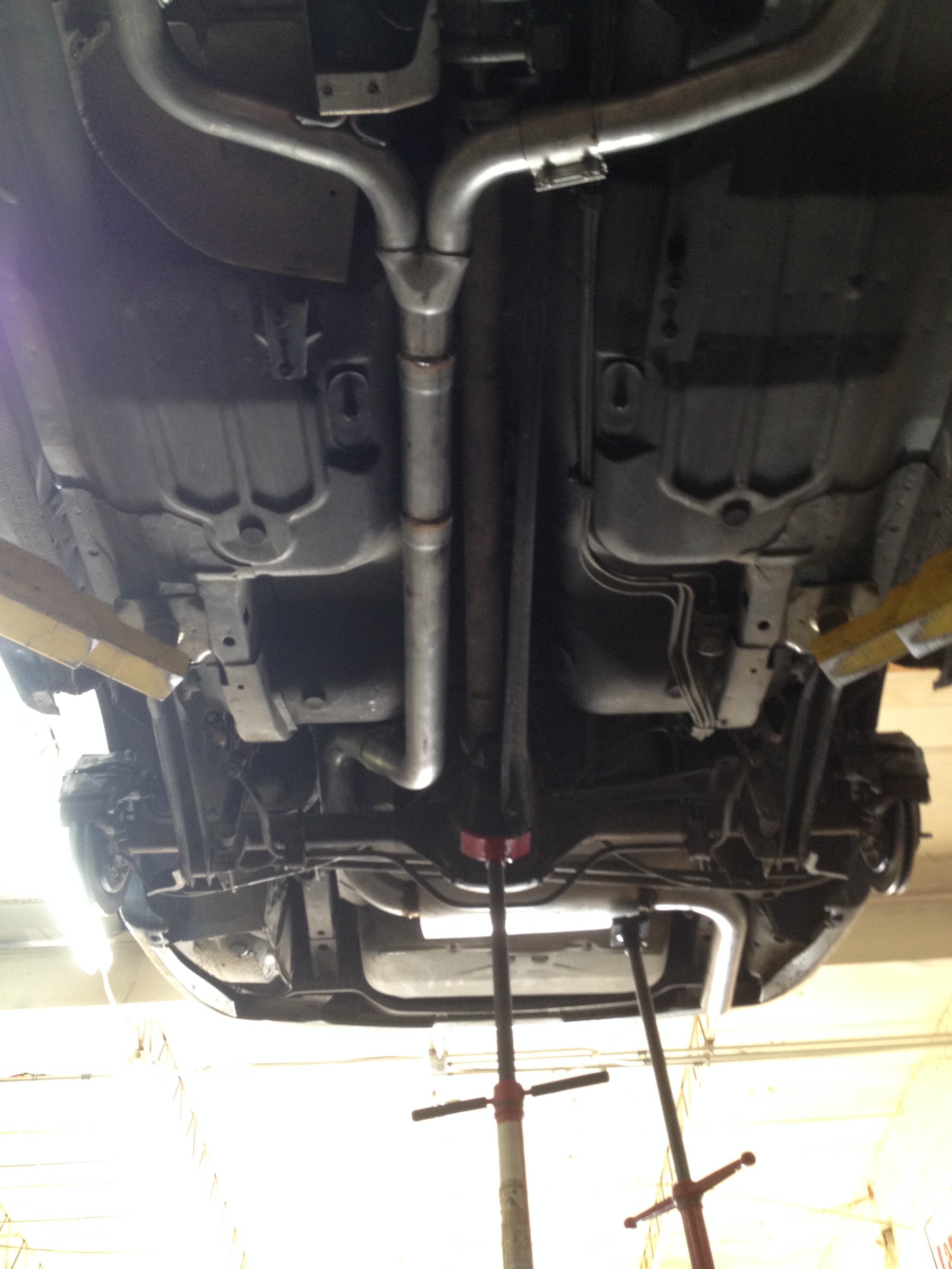

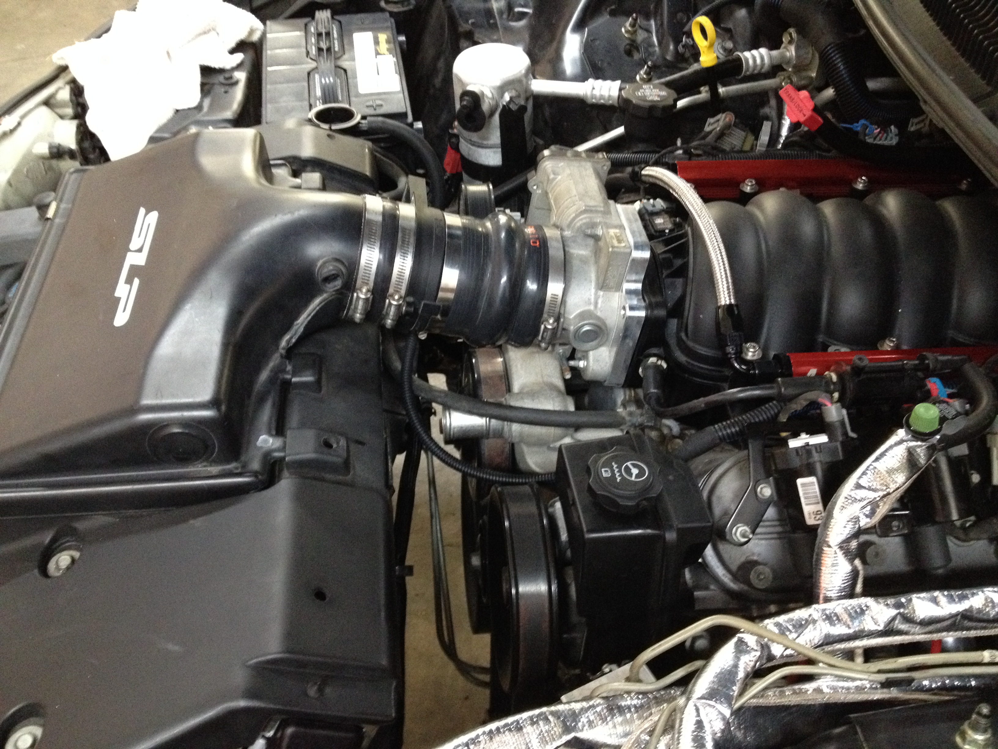

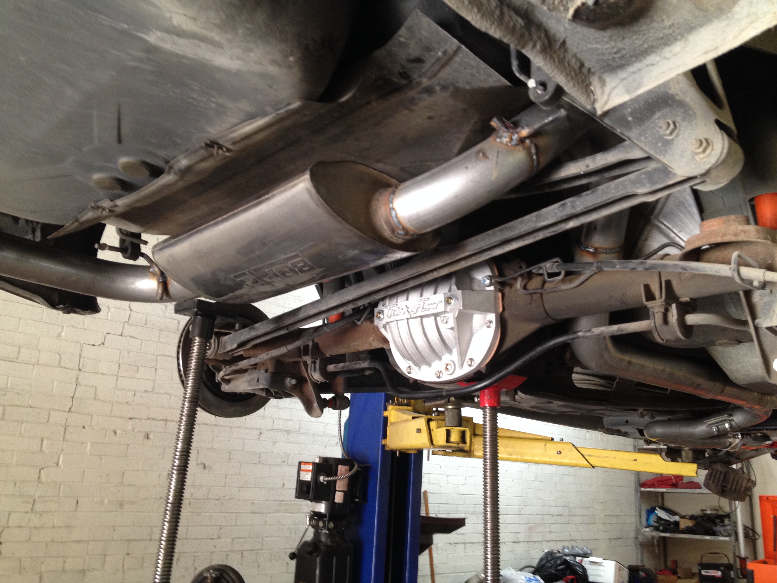

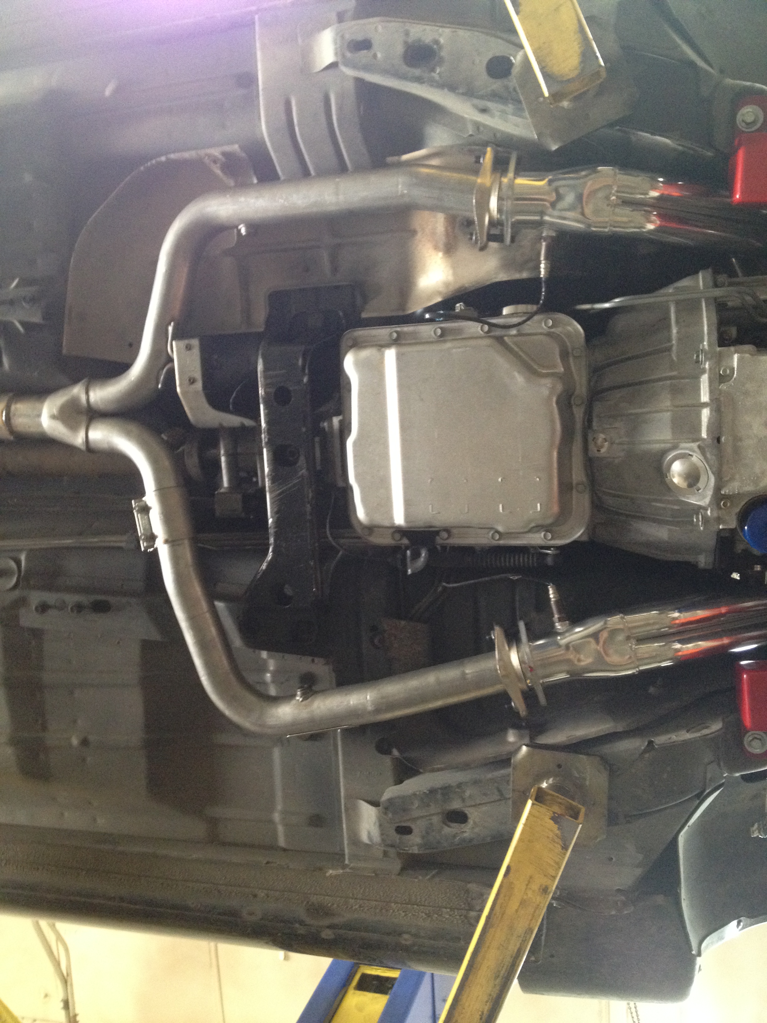

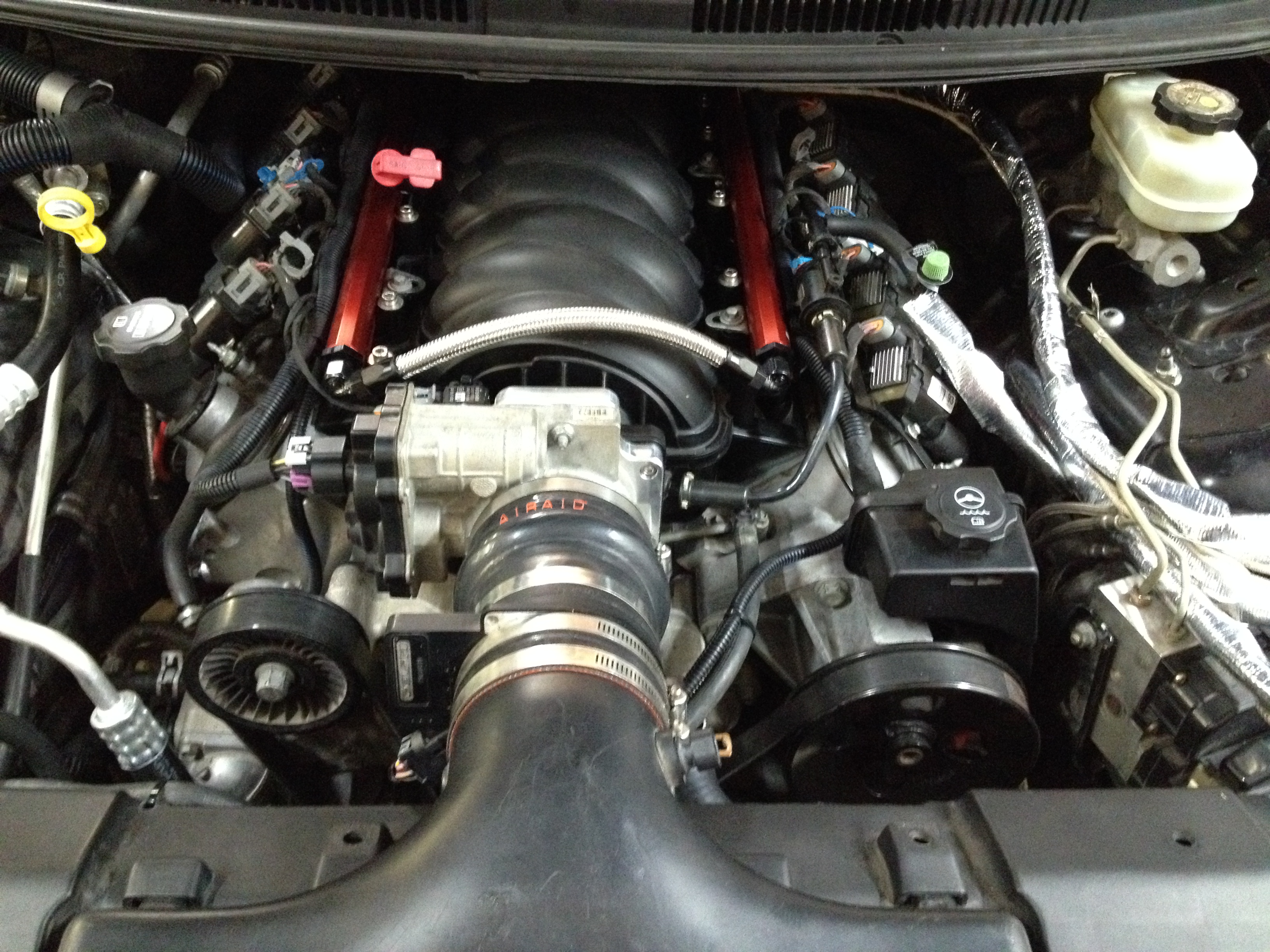

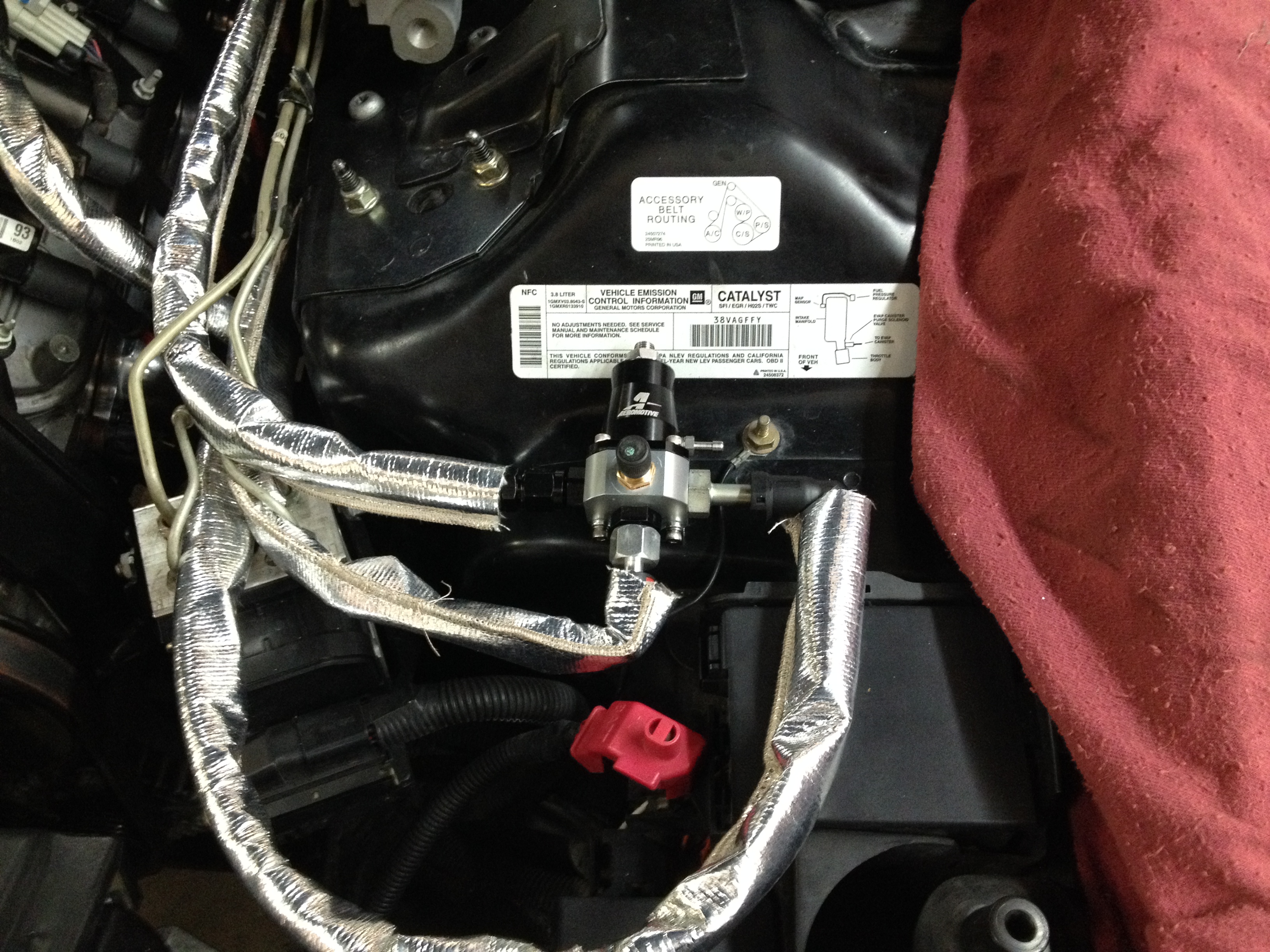

Just need to Wire the Cruise, Alignment, Tires mounted, And above all else a PCM so I can start the car!
Attached Thumbnails '01 Camaro V6 to V8 swap.-camero-engine-iphone-018.jpg   '01 Camaro V6 to V8 swap.-camero-engine-iphone-015.jpg   '01 Camaro V6 to V8 swap.-camero-engine-iphone-022.jpg   '01 Camaro V6 to V8 swap.-camero-engine-iphone-056.jpg   '01 Camaro V6 to V8 swap.-camero-engine-iphone-073.jpg

looks great ? your staying with the single exhaust ,you may find the get up an go it not there ,I just feel anyone not running straight pipes is just loseing out ,now that I feel the power ,with the old exhaust I got a lot of vibration ,an to much back pressure coused a leak ,so looking back ,but if its what you like ,or going for a sleeper look ,let us hear it ,still don't know why they don't move you to projects ,after all its a project right an engine swap,looks like your moveing along great,this could be a popular swap I see one can bye the short block rebuilt gm product for like $2300
It is Mandrel bent 3" from the Y-pipe back, Keep in mind stock Z28's have compression bent 2.75" pipe from the Y-pipe back. I'm running a 3" Borla muffler as well. I'm worried about it being TO LOUD...This is going to be my daily driver.
