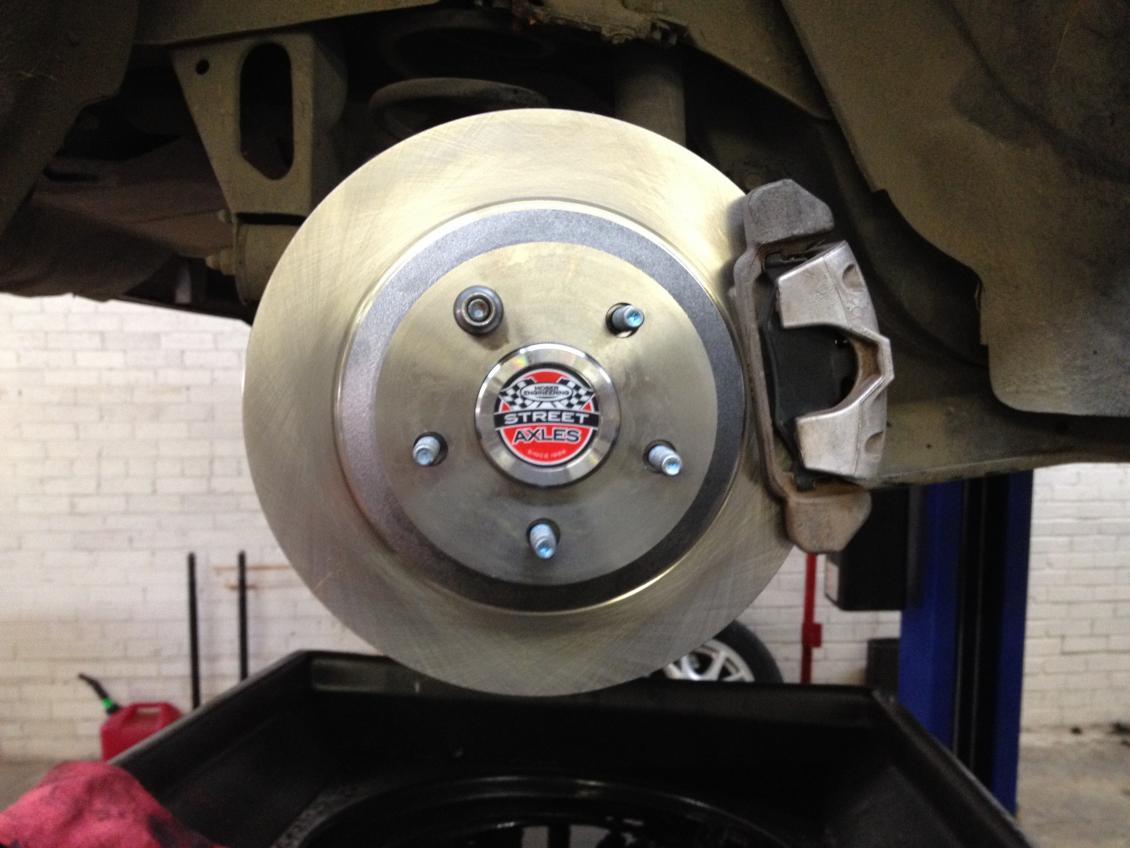

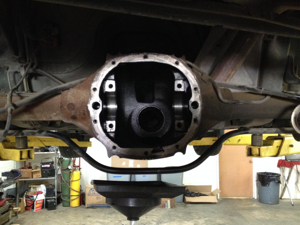

Started with rebuilding the Diff, I found the noise it was making...Driver side Carrier bearing was shot. I originally thought it was a Axle bearing.
Everything set right up with the original shims. .030" pinion shim & original 1-piece carrier shims. Surprised me with using a 2-series Carrier & a "Thick" 3-series conversion gear-set.
Replaced the rear rotors & pads, AC-Delco Rotors & GM (PBR) pads.

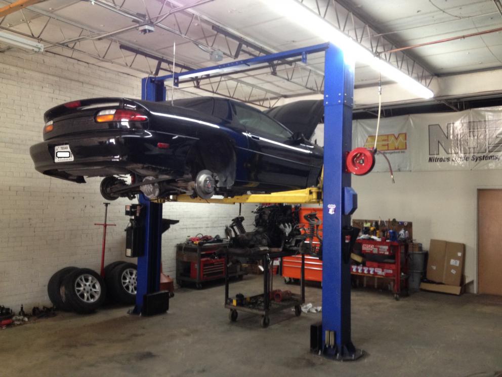

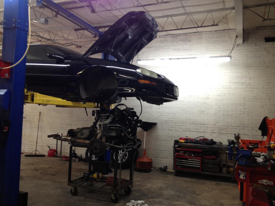

The Diff build went so smooth, I decided to go ahead & pull the engine/trans today. These cars are unbelievably easy to pull engines on. Took 1.5 hours. I'm sure it is a nightmare without a lift though.

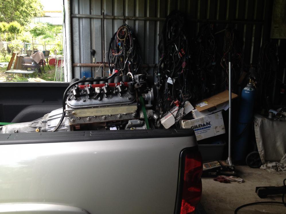

Made some more headway today, Hardest thing was to get the engine/trans loaded in my truck. The hoist I have at home couldn't lift it high enough. Had to let the air out of my rear tires to get the truck low enough to load the engine.
Note to self..Replace hydraulic cylinder on home engine hoist.
Stripped all the suspension/Brake lines & Rack off the V6 K Member.
Got the Engine, Rack, Brake lines mounted on the Spohn K Member, Trans Lines, Headers, Spark plugs, Plug wires, & O2 sensors installed.
