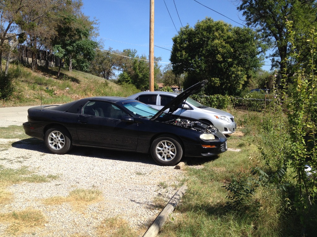

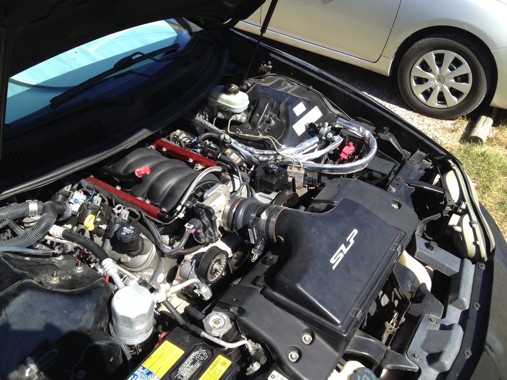

Old Sep 20, 2015 | 06:47 PM
  #49
clinebarger's Avatar
Joined: May 2015
Posts: 75
From: Fort Worth, Texas
ironic mabey i see a 01 camaro with 5.3l for sale the guy bought it out of texas ,i can tell its a swap .63000 on the engine ,i been looking all over for diffrent prices on 4 gens ,mabey its just a coinsidence wonderlake.chicago .humm ,79540. on car ,we nev. er did see this car run
This is the car you speak of? 2001 b4c camaro boost ls1 5.3 79k miles
Not my car man! But I have been driving my car a lot, Got all the bugs worked out & I'm loving it!
