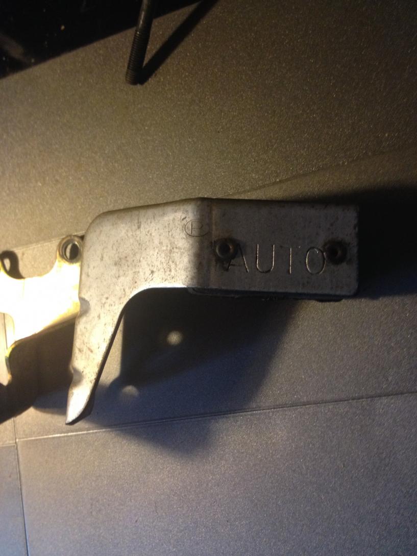

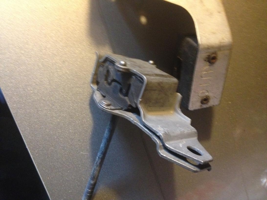

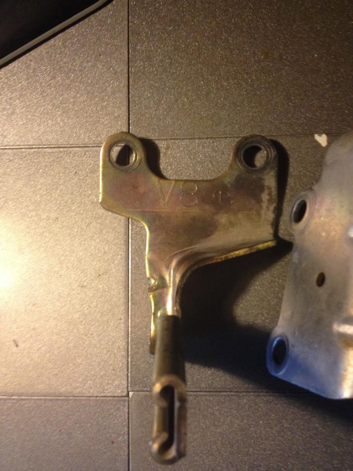

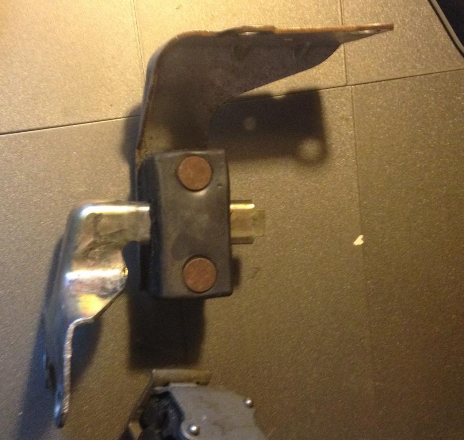

I found that the exhaust hanger (Off the back of the trans) is V8 specific, Not a big deal but thought I would share. The Hanger mount appears to be just Auto specific.
Got a new Torque arm mount, $40 at the dealer.
