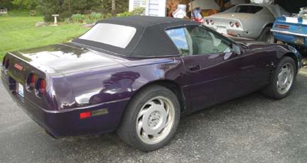

Old Sep 7, 2011 | 04:23 PM
Originally Posted by Stevolwevol
A vette????
"A" is such a loose term!
