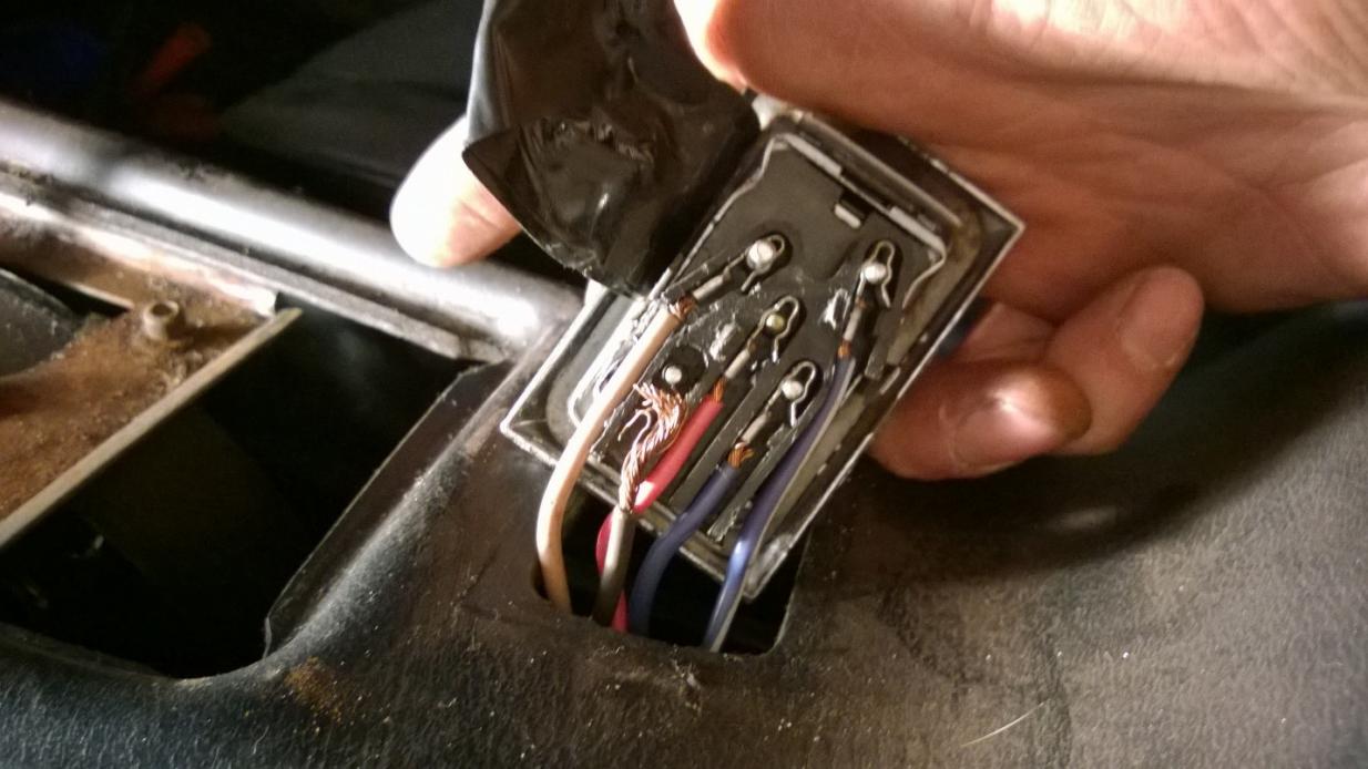

The main connector body looks to be all there. Just missing the one clip connector. If you can't find the correct clip at a wrecking yard, you might be able to bend one up from some spring steel or piano wire, and then use a butt splice to crimp it to the end of the wire. I've got several rolls of different size piano wire and I often bend it up to make clips or springs. Works really well, and holds tension great.

I looked at a switch at NAPA today. Yes all the pins were exposed and there should have been a plug. I was thinking yours had the back of the plug missing. Maybe an older style? late 60's early 70's?
Pico Wiring
PN 5846C
Example of switch
Example of mine and the same as the one in my truck.

The second example is the same as the one in my Camaro also. I haven't pulled the connector off of the switch to see the pins but it looks just like the pic of the one you have also. The PO had the wires all criss crossed when I got the Camaro though, dr side switch would operate the pass side and the down would make the window go up etc. so I had to move them around a bit lol.

Yep, that's what they look like with the connector pulled off the switch.

Right Val but all the ones I have ever seen have a plastic plug witht he wires coming straight out the back.
This I have never seen until now.
Old Jun 8, 2014 | 09:46 AM
  #837
Interesting Damon. Most I've seen had the connector with clips as shown. I bet either connector will fit the same switch though.
Old Jun 8, 2014 | 02:17 PM
  #838
I was thinking the same thing Val.

Funny thing Val. I looked at mine today. Same exactly. Mine has a cardboard cover staked to the stitch to protect from shorts but the same nonetheless.
