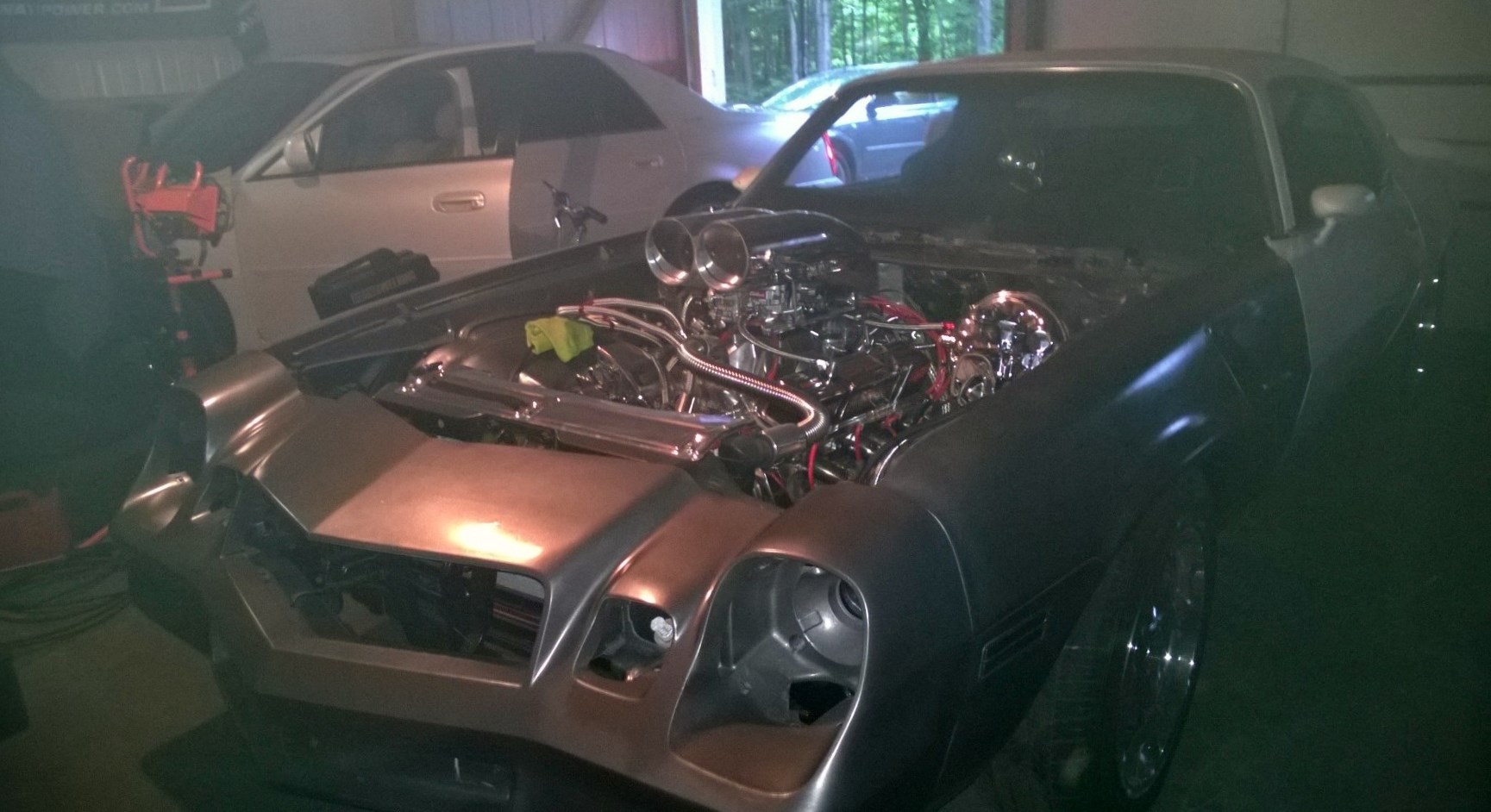

Just got back into town, been gone all week so I haven't done anything to the Camaro. That's what I'm going to have to do for the fender mounting spot by the door then. Was pretty much thinking that was my only option as there's no way to access the area behind that hole by the door hinges. Probably not going to mess with it until I pull the fenders back off for bodywork next year.
Vall, I've got vacuum, it just didn't change the idle when I pulled the advance line off. One thing I did notice (well 2 things actually) was that vacuum was a bit lower than it was the last time I checked it. The other thing that was discovered and most likely was not helping with the low vacuum was that #6 spark plug wire was almost off the plug and (yep, again) started melting to the header. It wasn't off the plug completely but was not "clipped" on and was pulled back far enough to be resting against the header tube. So, I'll replace the melted boot with a leftover from the new set and before reinstallation will be modifying the billet separator on that side to hopefully eradicate that problem once and for all. Thought I had it fixed, and probably would've been fine if it was securely attached but not taking any more chances. Anyway, I'll take a look with a vacuum gauge again once that's all done and the battery is back in there so I can see what's going on when it's firing on all 8. Got the nose almost completely installed, just a few more bolts by the pass. side headlight area. I want to finish the reassembly of the front end and get the lights back in there so then I can specifically focus on getting these last couple issues resolved.

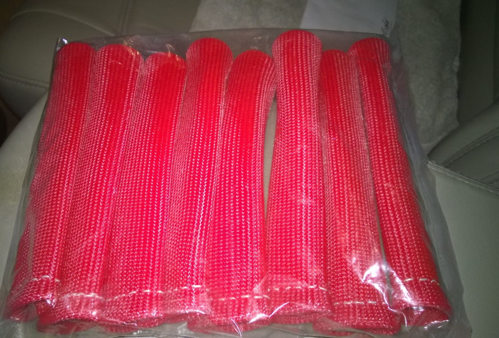

You need plug boot insulators! Oops! I already said that before!

Not sure if I mentioned it or not, but I DID order boot insulators. I used the link you provided to find some red ones but they take a little while to get here from Shang Zhen. Hope they're not defective. Not gonna need them after I whittle the billet separator down a little like I did the other side but if it should come to that, I'll use the insulators. They're not going to help keep the wire on the plug though, that was my fault.

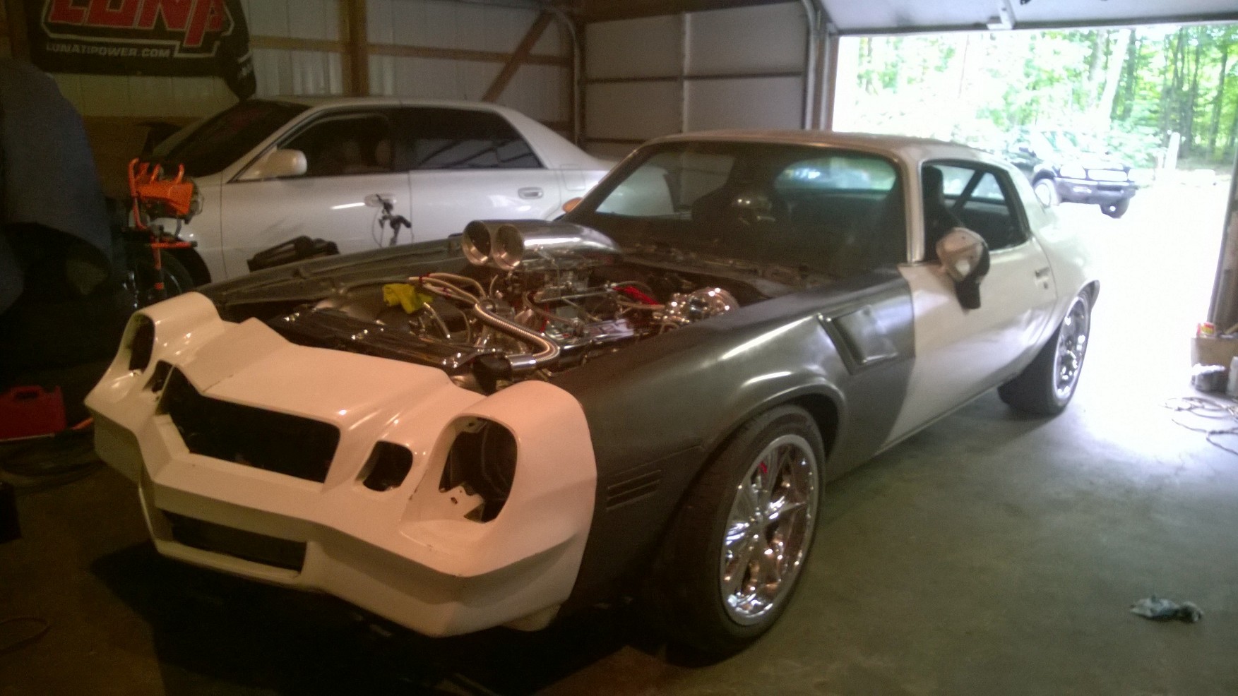

Ahh so. Ni Hao spark plug wire insulators! Specio dewivewy in the mail today, straight from a Chinese speed shop. Suppose I'll utilize them since I've got 'em but something tells me they won't withstand 1200 degree temps as the listing stated. There's only one plug left that the wire is close to the exhaust, but might as well.
I've not had any trouble getting the wires on and off the plugs, just a few spots where I can't really get my hands in there to fit it over the plugs. The silicone is a good idea but I don't really feel like driving into town for it right now.
I had 15" of vacuum late last year when I checked, that was before fixing the issues I was having with high idle and glowing header tubes. When I checked last week and saw 13" that was when a plug wire was off the plug. I spent yesterday getting the front end finished up. I threw some paint on the nose and had to wait for it to dry before getting the headlights/wiring installed. PITA getting all that wiring shortened and tucked away from that headlight relay wiring kit I got a few years back. Hope to have it running later on today.
