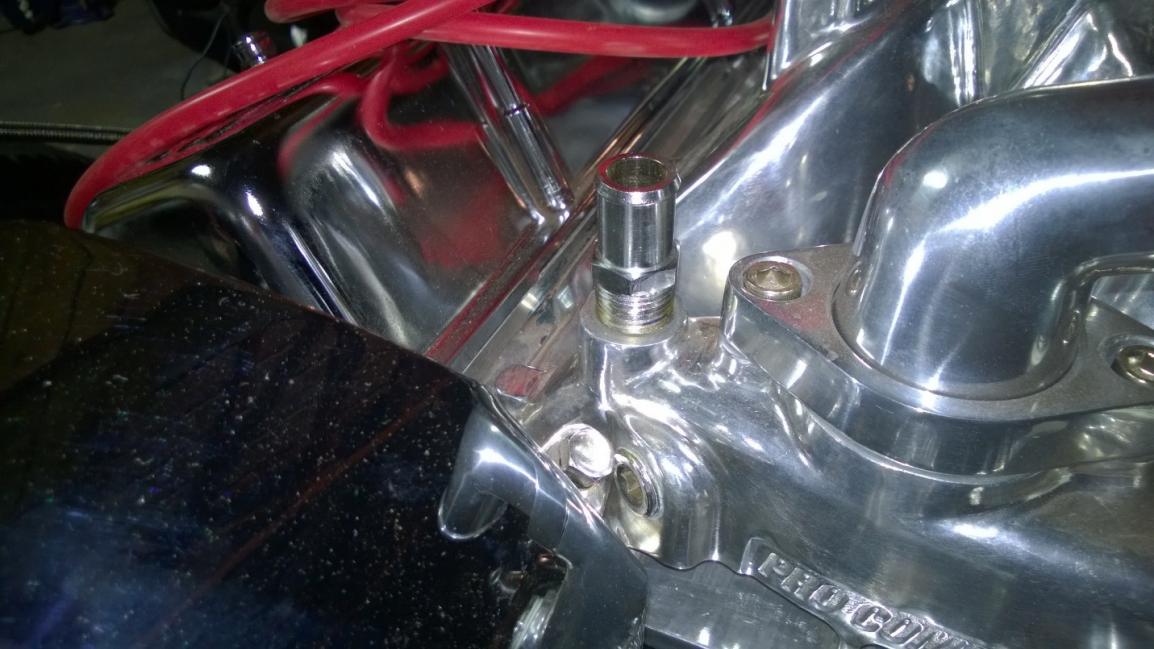

Here's a pic of that heater hose fitting that visited you Damon. That's as far as it'll go in right there. Catches the first 3 threads, that's it. I'm sure if I used sealant it would work but man, I can't stand how ridiculous that looks! Might just end up using the plain fitting that I got from the local auto parts store. At least that one threads down in there. What a huge time waster this fitting has turned out to be.

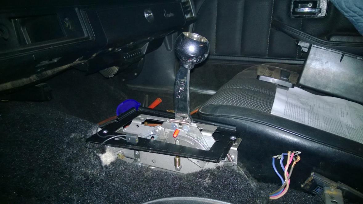

Anyone ever have issues with a new B&M shifter not wanting to go through ALL the gears? I'm not even hooked up to the trans yet and I can't get this shifter to go from neutral to reverse, to park?! I'm confident it's got something to do with the tab (whatever it's called?) on the side with the red plastic cap on it. If I manually shove that tab/lever I can get the shifter to go into park, but then I lose second and first positions. No troubleshooting instrux cover that lever thing on the side so I was just curious if anyone else has dealt with this before?

Haven't had that particular B&M shifter, but I have had occasional B&M shifters that hung a bit going from 1-2-3-N to R-P. Never had issues with forward drive selections, or issues once they got past neutral, but the reverse lockouts can sometimes need fiddling.
That particular shifter is similar to my Pro Ratchet. You can shift 1-2-3 up and down without an issue, but the little lever on the side locks out N-R and P. In order to go to N-R-P you have to go to neutral, then push the small lever forward once. At that point it unlocks R-P and your shifter will go into those two. Reverse takes one click, but it takes two more to fully engage Park.

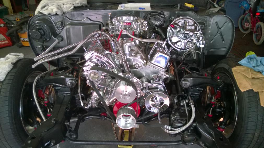

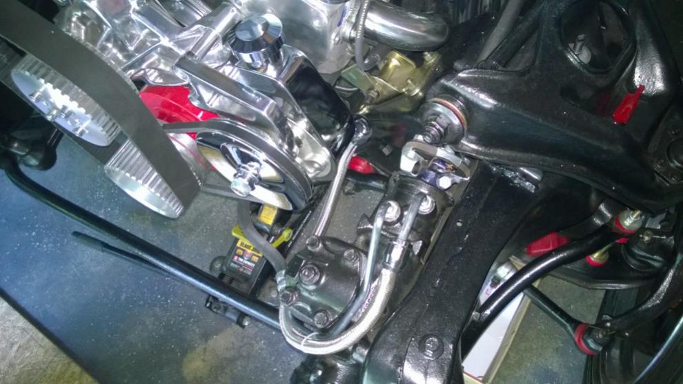

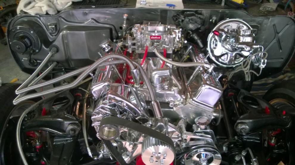

I messed around quite a bit with the shifter today and managed to get most of it adjusted properly. Wish the car was running and driving so I could tell if the linkage is adjusted properly, feels like I might be a tad off down in 1st gear. Didn't get back under there to check the cable tension when in first gear over the cable pin, I'll finish it up tomorrow. Appreciate the insight Vall, the Proratchet is similar to mine but mine does not use the actual red lever to get into reverse.
Got a ton of little tasks completed today on the Camaro, and even got some sanding done! Power steering is completely plumbed, heater hoses are on, all vaccum lines are installed, throttle linkage and kickdown linkage is installed and adjusted (for the most part) body mount bolts are torqued (still need to drill the holes and add the 4 bolts to the sfc's) fuel line to pump is completed, LED's are installed in tail lights awaiting the housings (waiting on power to make sure lights work first) and the speedo cable is up to the dash, just not plugged into speedo yet. I'm really gettin' there, couple dedicated days to wiring the ignition, electric fan, trans temp gauge and a load of switches as well as doing the pump to carb plumbing and it'll be ready to fire! Still have to go over every bolt on the suspension and finish greasing all the fittings in the front end but for the most part I'll be ready for the core support, inner fenders and finishing the trans cooler mounting. I made another checklist and that's what's left, aside from the new seats, steering wheel and the driveshaft. Slow but steady...
