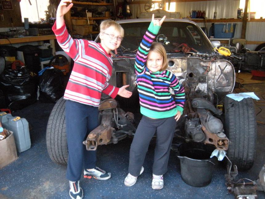

Success! Finally got the brake booster off the firewall. Ended up getting really irritated and busted out the grinder to cut the bolt down so I could try and fit a socket in there. The nut broke free right after I cut the bolt, go figure. Got the steering gear box out, the bolts look they're in great shape still Damon. Couldn't get the pitman arm off the center link so it's time to invest in some pickle forks. Gonna need 'em anyway for the rest of the suspension. At least I can finish the firewall now!
With respect to measuring vaccum for the brakes, I guess my question now is what if it's really low? Are the smaller boosters better than the OE stuff or the other way around?
Gotta look behind the dorks to see the progress this time.

LOL Cue Shameless photo of children.

LOL, and oh so presentable kids too. This was a celebratory pose for finally getting the booster out. You'd think my kids had never seen a camera before. I had my son taking pictures of the firewall etc. for me (big mistake) while I was trying to work. His finger is over the lense in EVERY SINGLE picture! So I finish up and try to take a pic or two myself and there they are, bed head still kickin'. What do you think happens next? Yep, the battery dies in the camera.
