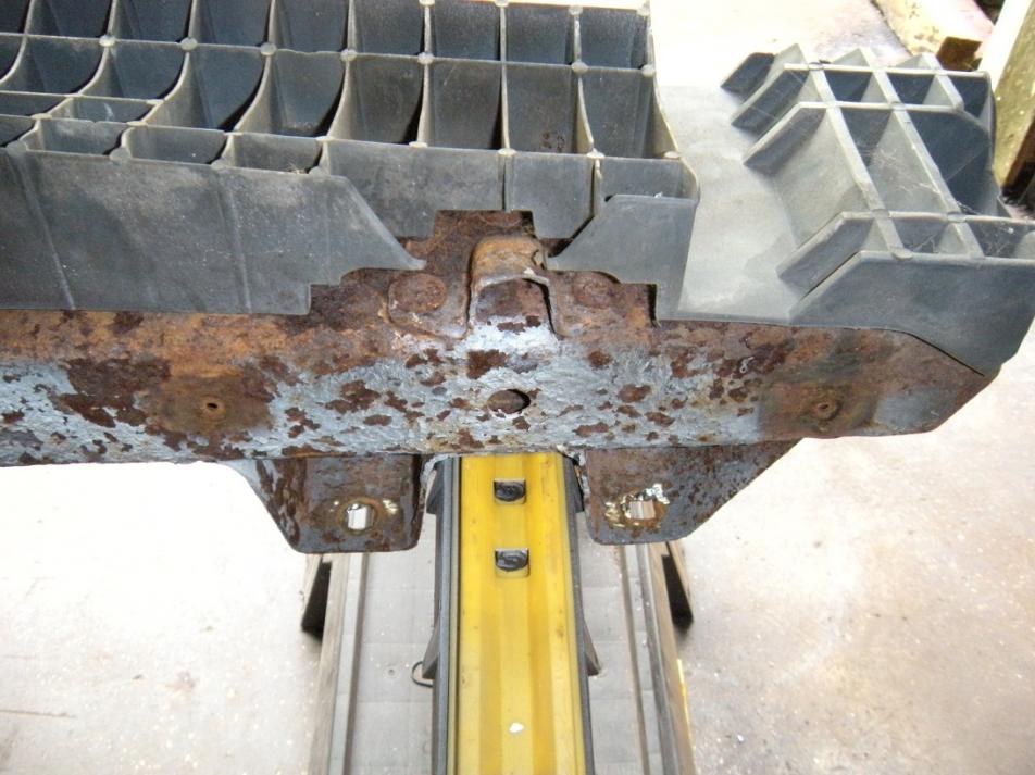

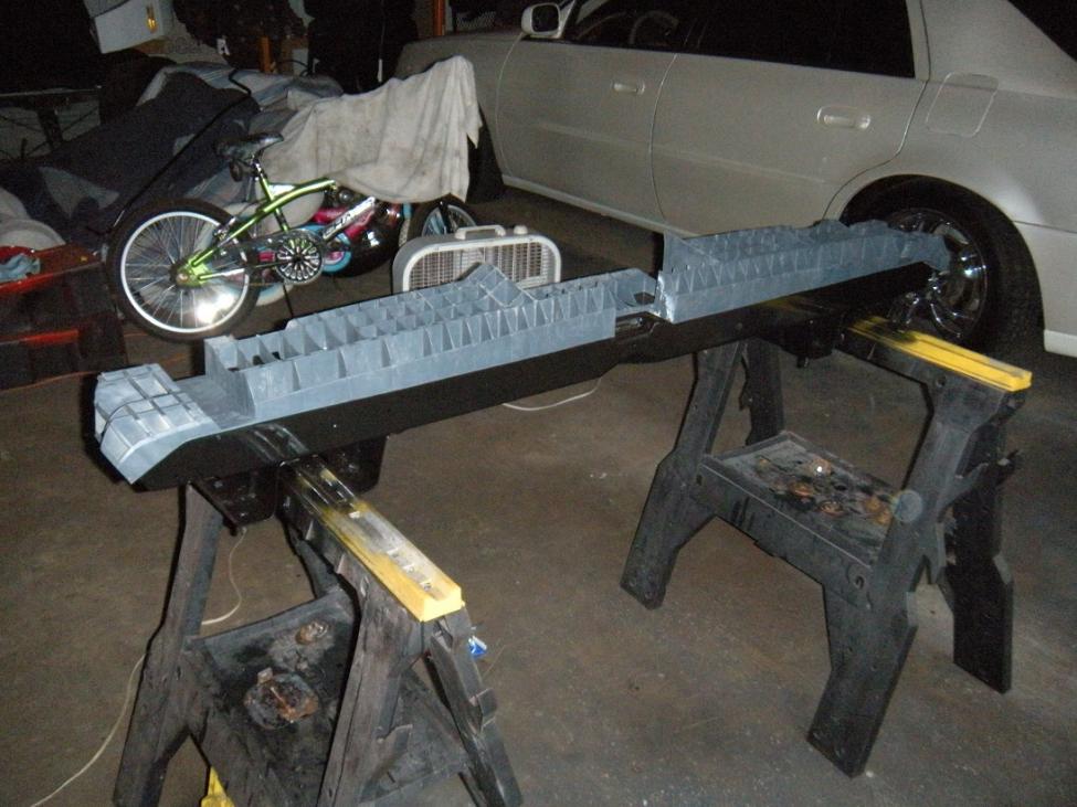

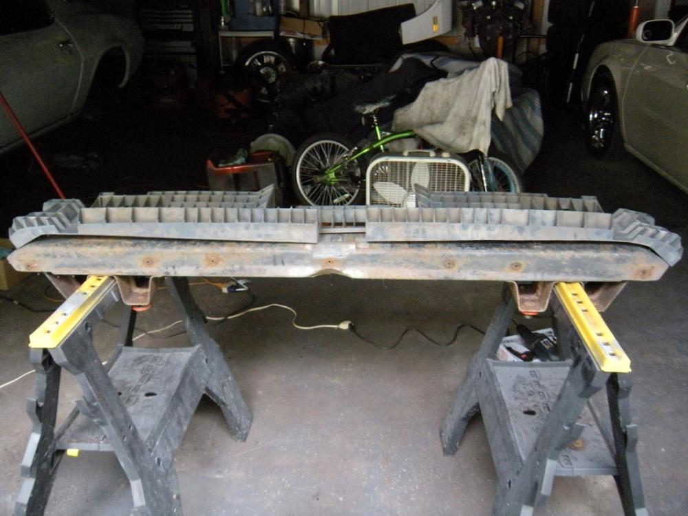

Not the most exciting of pictorial updates, but it's done nonetheless! Now, if the Camaro only had a clean, painted surface to bolt this back up to. I'm gettin' there.

Dang! Is that POR on the steel? It looks like it laid perfect. I need to know what you did to clean up the plastic. I want mine that clean too.

I didn't POR the bumper, didn't want to open the second can and have it petrify before getting to the bottom of the car. Just used the Hi Perf Rustoleum rattle can on it and it turned out pretty good. I might go back another time and POR it but I'm thinking it'll be good for several years at least this way. Cleaning the plastic wasn't very enjoyable but the detailer in me reared it's head on that one. I did manage to hold off on any silicone dressing on it though! I started off with a brush and Simple Green on some of the larger openings and ended with a dishrag and a skinless pointer finger on the smaller ones. Used the garden hose and waited for it to dry then went back and hit the spots I missed the first time. There was some white overspray left on it and I went back and took that off too as I didn't expect it to end up looking like it was new again. So, to answer your question, nothing special really. About 20 minutes total.
