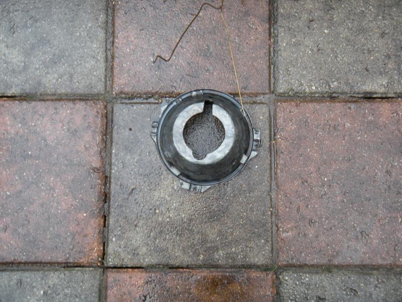

Here's a couple pics of some parts after soaking in the molasses solution. It works beautifully I must say. This is going to save me a ton of time and effort from sanding/wire wheeling all these parts. I was skeptical at first but I'm so glad I made this solution. Just wish I had a container big enough to submerge the subframe in! There's a money making venture in itself for someone who's got a big enough bucket!
Before and After pics:

Those look great, and they didn't eat the skin off of your hands either eh?
So how long did you have them soaking? Did you need to do any brushing or scraping mid-way through the soak cycle?

Appreciate it. You can definitely smell the solution when you take the lid off the container but again, it's cold so it's not bad at all. When it gets to be much warmer I'm sure it'll be pretty pungent. Small price to pay IMO, doesn't smell bad. Normally I would don the use of gloves when working with this stuff but today I was so excited to have my power washwer back in action that I just went in and grabbed the stuff out and went to town spraying the rust off. They were in there just over 3 weeks only because of the washer situation. I never touched the parts with anything but solution and the water today. There's a couple spots on the headlight buckets that I will probably brush (or may even just wipe with my hand) to get the remaining little bit but I didn't have to do anything but wait. If I was more pressed for time I'm sure a brush and a smidge of elbow grease would've expedited the process also. I'm looking forward (for another reason now) to the warmer weather to see how much faster this stuff works. Pretty confident that it doesn't have to be weeks for good results either. I don't have anything that has that much rust luckily.
