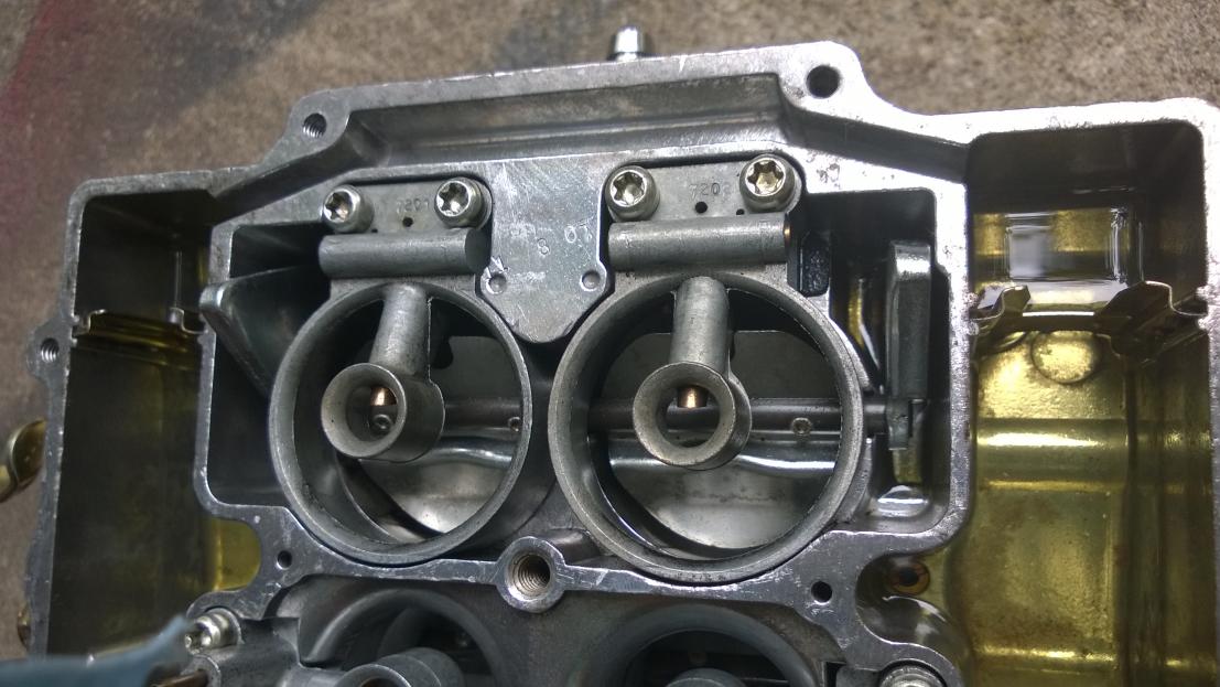

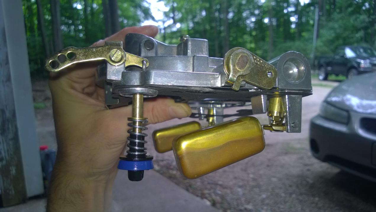

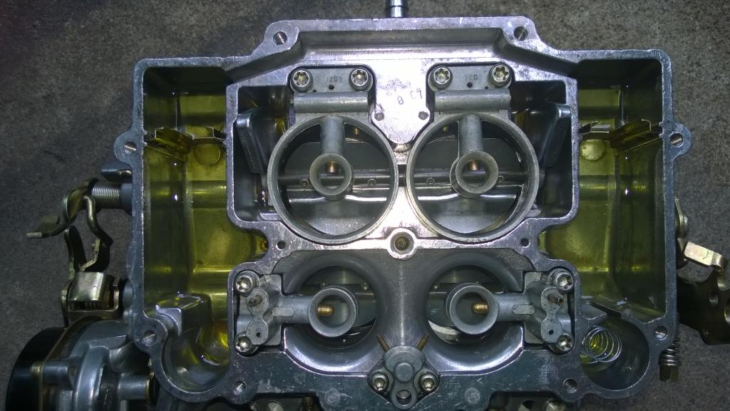

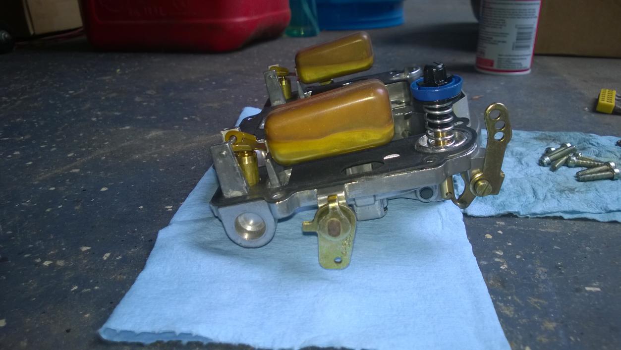

It's flooding. Really don't think there would be that much fuel in all the spark plugs if it wasn't. I'm quite confident the issue isn't valves not closing. Don't have a compression tester so that's out, at least right now. I just pulled the carb back off to check everything, again. Don't know what I'd actually be looking for but I pulled the floats off, needles out then removed the seats. Nothing in them and the needles drop down with the floats when I turn it over. Fuel level in the bowls seems right in line with the float level. Didn't spill a drop of fuel when I removed the carb. Curios if there's supposed to be fuel in the area where the secondary flap is? I'm going to put this old carb on and try it out. I'm wondering if it's a pressure issue. Not sure what to think with this gauge anymore after I removed it the first time. Always was right on 6psi before I took it apart. Now, it only goes up to 3 and drops back to zero fast after I try to start the engine. I adjusted the regulator down/out to see if that'll help but probably should've waited on that until I put this other carb on there. Didn't turn it out much.

I don't know zip about those Weber built Carter, Edlebrock, carbs. I usually want a float to be level when it's turned upside down. And I blow into the fuel inlet with the float upside down to see if air will pass. If it does, then your needle/seat is faulty.
Fuel pressure could easily push past the needle, if it's over 6 lbs.

Vall, floats are supposed to be 7/16" when held upside down. Supposed to have 15/16" of drop when turned back up. I measured and adjusted and measured and adjusted until they were both exactly to specs for both drop and level. I'm going to say the needles are a bit suspect. When I dumped the fuel out and everything dried, there was one that was not wanting to drop down when I turned the top over. It would stick for a second or two and then drop down. One time it stuck and I had to tap on the airhorn to get it to drop. Still don't have a running Camaro so I have no idea if that's causing anything or not.
