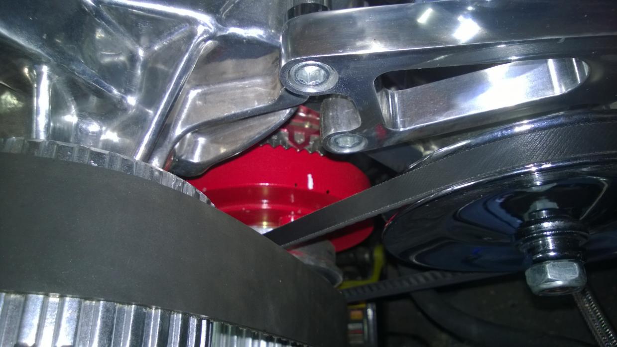

Going through the checklist very slowly, seeing as it took me almost 90 minutes to get the engine turned over forward and back to find true TDC. Had to remove all the lock nuts on the rockers before it would turn over easy enough as to not loosen the crank bolt going backward. What a ridiculous PITA! Here's a pic of my marks with the piston stop. One thing off the checklist that I knew was correct but spent a ton of time triple checking to confirm what I already knew. Black marks are with the stop, white mark was the one I made when I put the balancer on and lined it up with the timing tab. Valve lash is next, again. I'm doing it the way I did it the first time, again. Having a friend stop over tomorrow evening so I can check spark on all 8 plugs/wires. New regulator and oil quarts 10-15 should be here tomorrow as well. Sure would be nice to have this thing running tomorrow evening, fingers crossed. Trying my darndest to stay optimistic about this.

Don't cut the tops off the valve covers! I just cut the top on the ends, and the side facing the intake. Then with the valve cover bolted to the head, I grab the cut edge and bend it straight up. This forms a splash pan to keep oil from hitting the headers. You'll need a gasket also, and I have mine stuck to the valve cover with RTV to hold it on permanently.
You might consider backing all the valve adjustment off 1/2 turn, and then if it fires you can do the running adjustment after it's running. I'm a little concerned that the engine turns over hard until the valves are loosened. And I never use the crank bolt to turn an engine over, as I've seen them stripped or snapped off occasionally. I use a flywheel tool that hooks to the teeth and turns the engine. Cheap at Summit, around $20.
