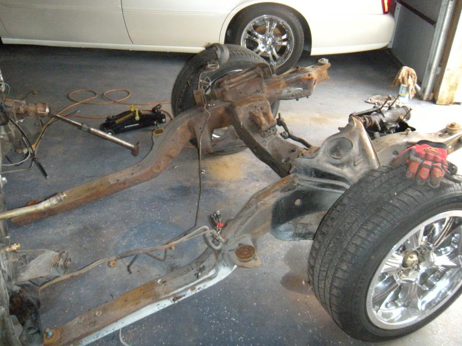

In case you guys forgot what a subframe looks like....
Attached Thumbnails The "Slow but Steady" '78 Project Build-dscn2336.jpg   The "Slow but Steady" '78 Project Build-dscn2337.jpg

I had a surprise in the garage today when I got sick of listening to all the "blah blah blah's" waiting for dinner to finish cooking. Apparantly I must've nicked the fuel line when I pulled the subframe out. I'm guessing a gallon or so steadily dripped all over the floor and was still going steady when I discovered it. Can't find a crack or hole but could actually hear the air/vaccum/siphon in the line when I lifted it up? I literally lifted the line up no more than 2" and it stopped leaking. Not concered about the line as I was going to mess with them anyway and get the return line removed and still need to confirm what the line is on the other side that certainly appears to go to the tank. Must be the charcoal can line like mentioned before but I'll say it again, it was connected to the cruise! Don't know why I'm so bummed about this as the tank needs to be dropped so I can get everything sanded/painted. Serious fumes in that garage, hoping the Cadillac won't have any lasting smells as it's in there with a window down.

If the line is lower than the tank it will siphon. The cap may be vented too. The charcoal canister line runs down the passenger side next to the brake lines. That could cause the siphon too.

I had the end of the line crimped with some vise grips so it wouldn't leak. Must've done something when I pulled the subframe out. I've got two lines on the pass. side. One went to the pump and the other was blocked off with a bolt in the end. Thought that was a return line but maybe that one was the line to the charcoal can? On the driver side I have the brake line and another metal line that had a piece of hose on it and went to the cruise but seems to go back toward the tank? I'll get them figured out.
Old Nov 24, 2012 | 08:08 PM
  #80
The two on the passenger side are supply and return. The drivers side is the charcoal/vent line. It goes back to the tank, turns to rubber and then back to metal and wraps around the tank if I'm thinking clear.
