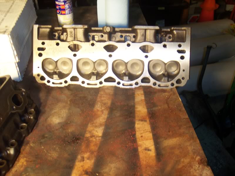

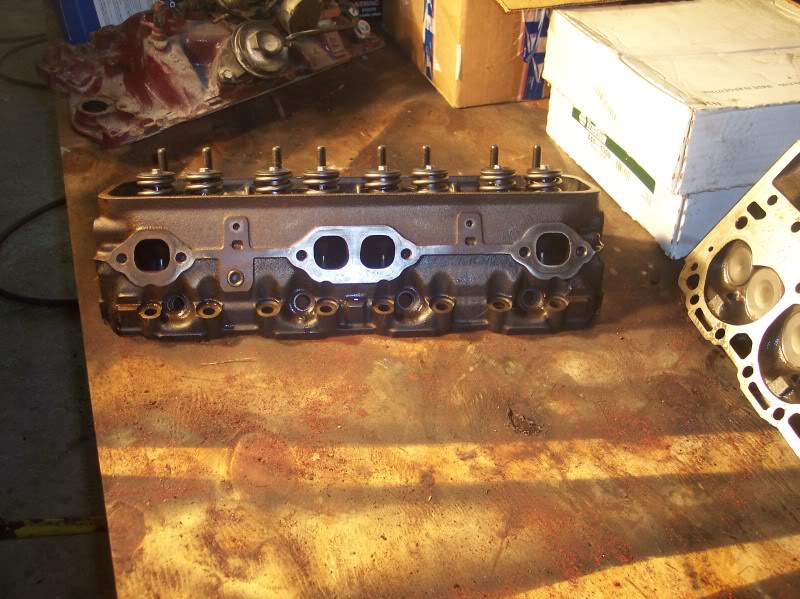

Just came into a good score. Got a set of Vortec heads.

They have been magged, cut for the bigger springs, and new valves, springs/retainers, screw in studs, and new guideplates put in. I hope that they do what I want them to. They do have the smaller 1.94 valves though, I really wanted to get a good set of aluminum heads with 2.02 valves, but the price was definitely right. Also came with alot of other toys that I am going to sell and get some $$$ to finish this engine and get it in the car.

You won't regret the Vortecs. Plus once you grow into you motor you can upgrade without much effort. 1.94s on those are said to be IT, as in going bigger would actually hurt performance. I'm just repeating what I've read as I don't own any.

Really pretty tiny difference between 1.94 and 2.02 valves, and as Damon said, I think the 1.94's will be a better head for a engine that's not highly modified.

I'll toss it together at any rate. Worst case scenario is that this winter, I'll "upgrade" it. Although, I'm really thinking that I'll probably just start another toy. From what I've read, these heads are very popular, I've no recollection of ever reading anything negative about them really. So, I should be pleased.
