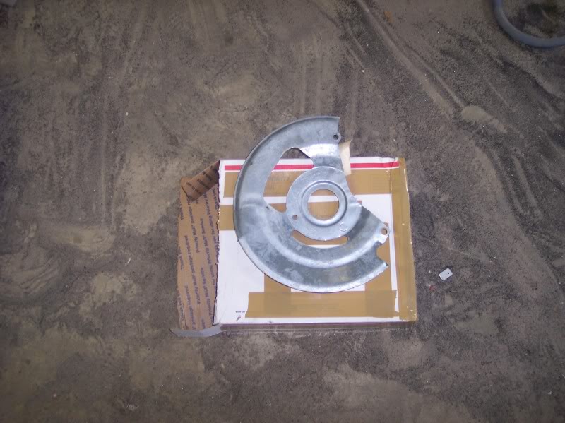

Asked for a brake dust shield, and got a New in the box one.

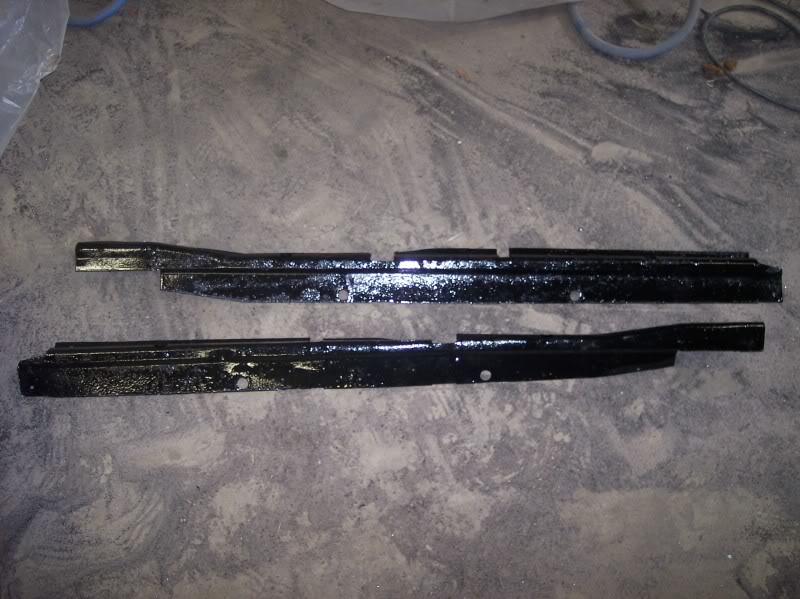

Asked for a drivers side wire molding for under the sill plate and got both of them, I may end up sandblasting them and getting them smooth and repainting them, but at least I least I have them now.

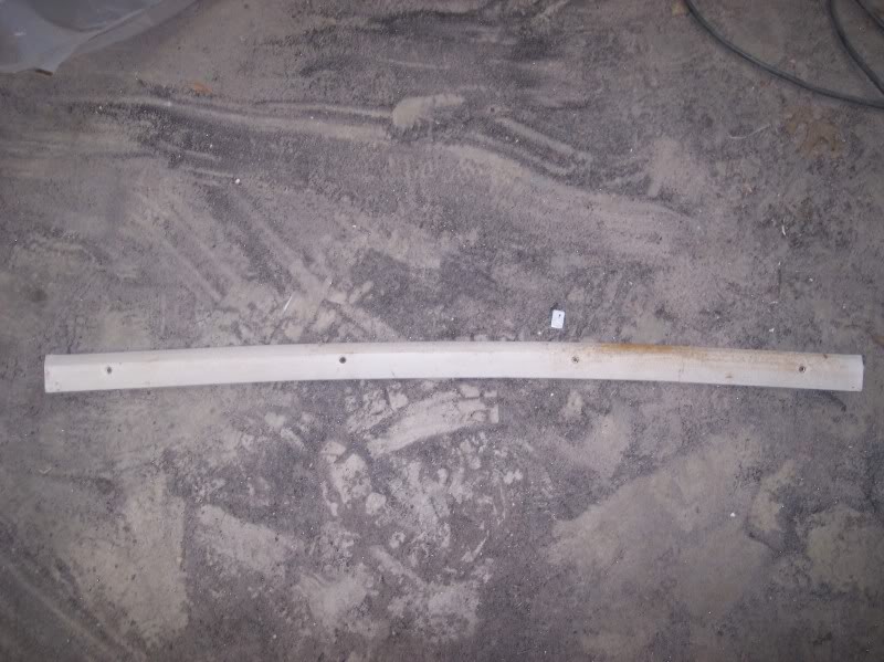

I also got a front headliner trim piece that isn't bent like the one I have.

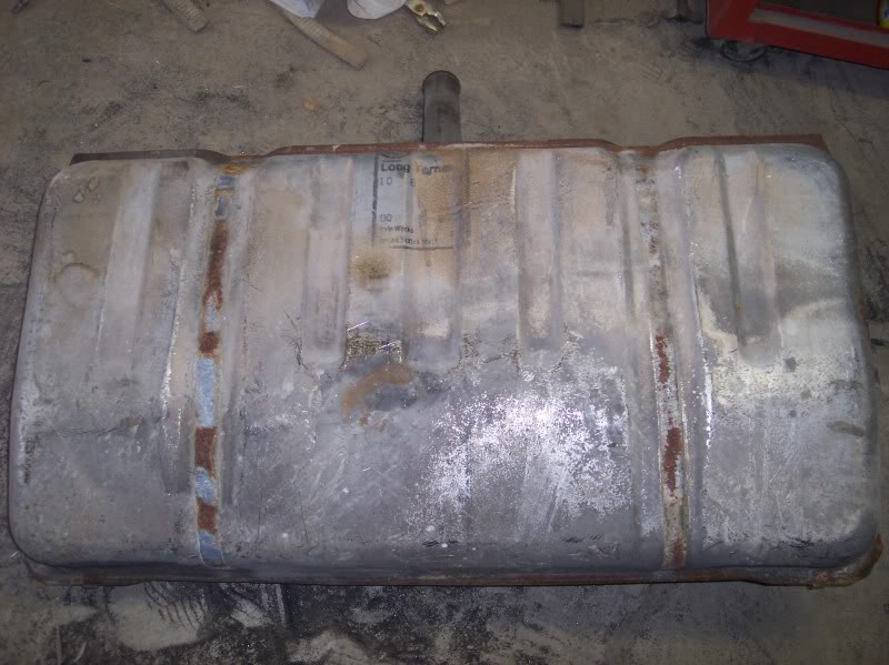

Spent a bit of time out in the garage tonight. I managed to get the fuel tank sandblasted and painted with etching primer. I am going to paint it up in hammered silver tomorrow. Not even 1 pic of what I did, the camera was dead! I need to leave it in the garage, bringing it in the house only encourages people to use it.
Hopefully tomorrow I can get my core support and fuel tank all done, I still need to push the car outside and blast my other inner fender and finish the fender with holes in it.

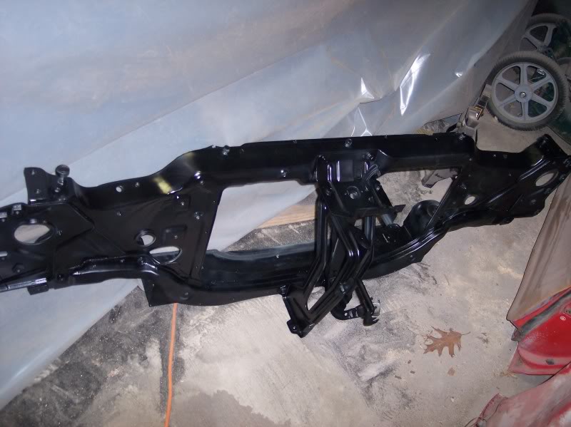

Ok, so I got batteries in the camera today, so I am playing catch up with photos. I had previously finished painting the core support and carried it over to the side, probably just to get all dirty from sandblasting, but hopefully it will wipe off when I go to put it on. You will notice the Lawn Mower buried back there too... I'll be needing that soon...

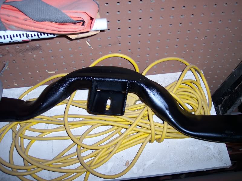

Here is a lovely finished Crossmember, it will probably get all scratched up putting the trans in.

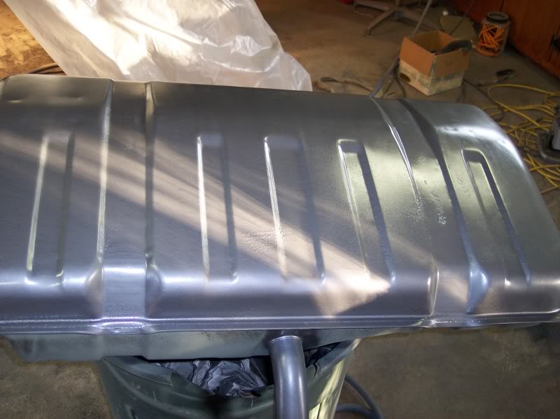

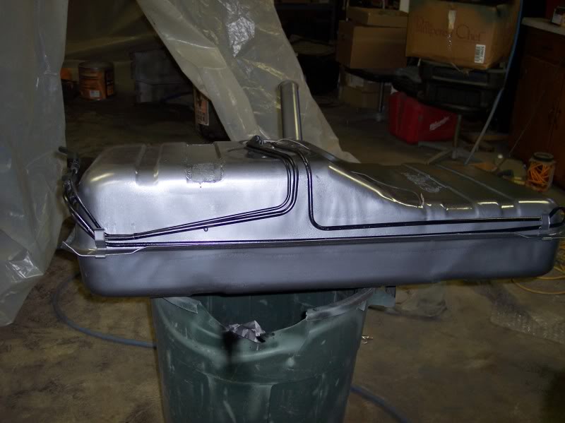

I went ahead and painted the bottom of the tank before I looked inside of it, I couldn't help it, lol.

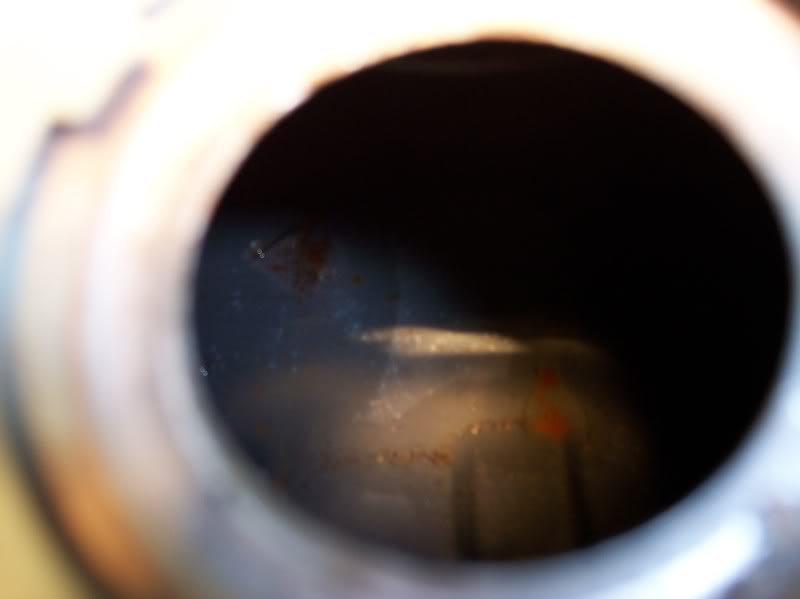

So, I flipped the tank over and looked inside, and this is what I saw, looks good to me, there was some carmelized fuel in there too though, I guess you can never be too sure:

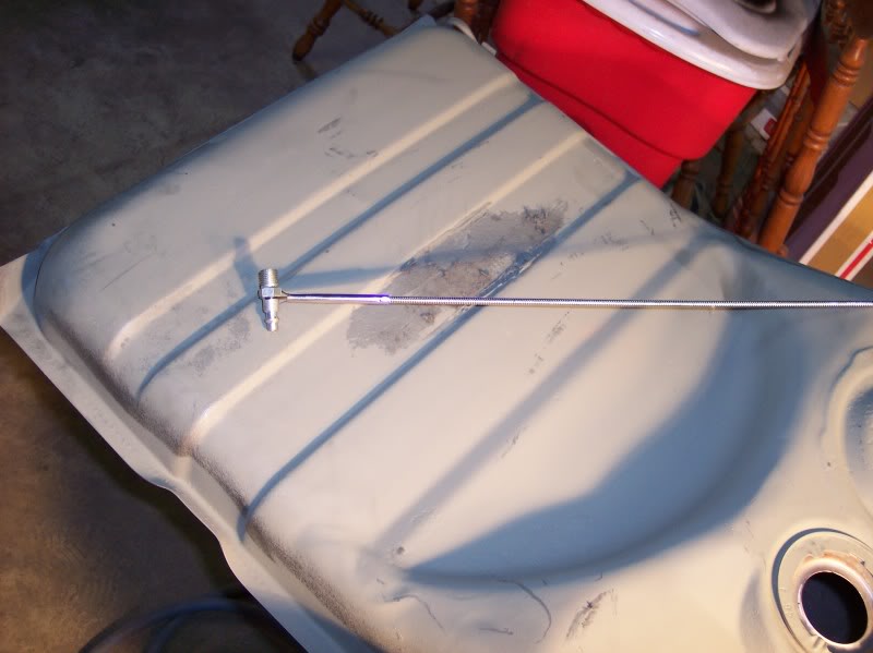

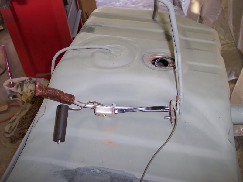

Here is the sending unit, everything looks good on it, I'm going with it.
And for whatever reason I cannot even begin to fathom, I figured I would flip the tank over, and just put a nipple in the air hose, and let the air blow whatever crap was in the tank, out. Needless to say, inserting that air hose into the nozzle caused the end to shoot off, into the tank... I even had thought that it could happen, but went forth anyhow...
I stood like an idiot with the tank over my head rocking it back and forth and shaking it around trying to get the nipple to fall out of the sending unit hole. I saw it skip right over the hole at least 3 times. Eventually I got smarter, and tireder, and went and got my headlamp and slowly moved the nipple into position where I could see it. AND THEN, a light came from heaven and I remembered I had one of those spring grabber things.

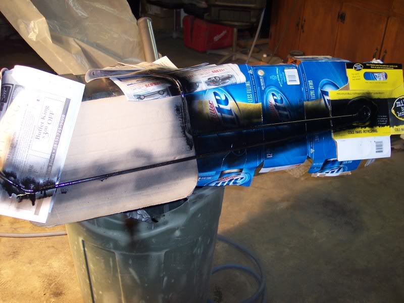

In order to get some flash, I decided to paint my fuel lines black.

Parts look great and the tank actually does look pretty clean inside! A good fuel filter should catch any carmelized gas that's in the tank when you get her running again. The fuel lines will also have carmelized fuel in them. When I got mine back on the road after 11 yrs. I plugged up the filter several times. I finally opened up one of the plugged filters and it had pieces of dried gas that looked like clear tubing inside it! Exact same size as the inside of my fuel lines!
