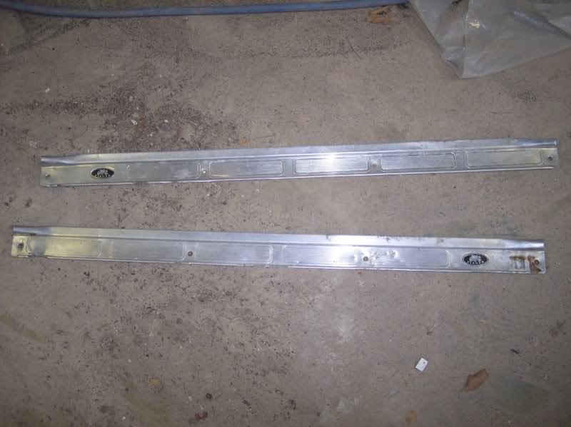

Got some Sill Plates yesterday. With a bit of elbow grease they'll be just fine. I still need the wiring cover that goes over the drivers side. I have one on the passengers side, not sure why I would not have one on the drivers side though. I'll need to keep looking.

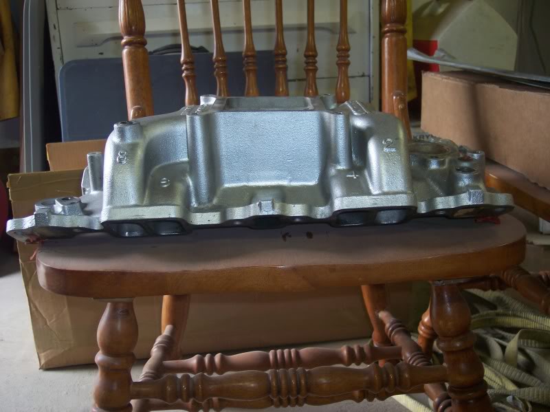

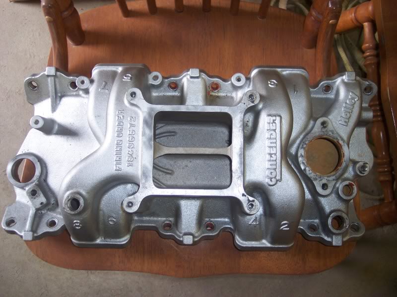

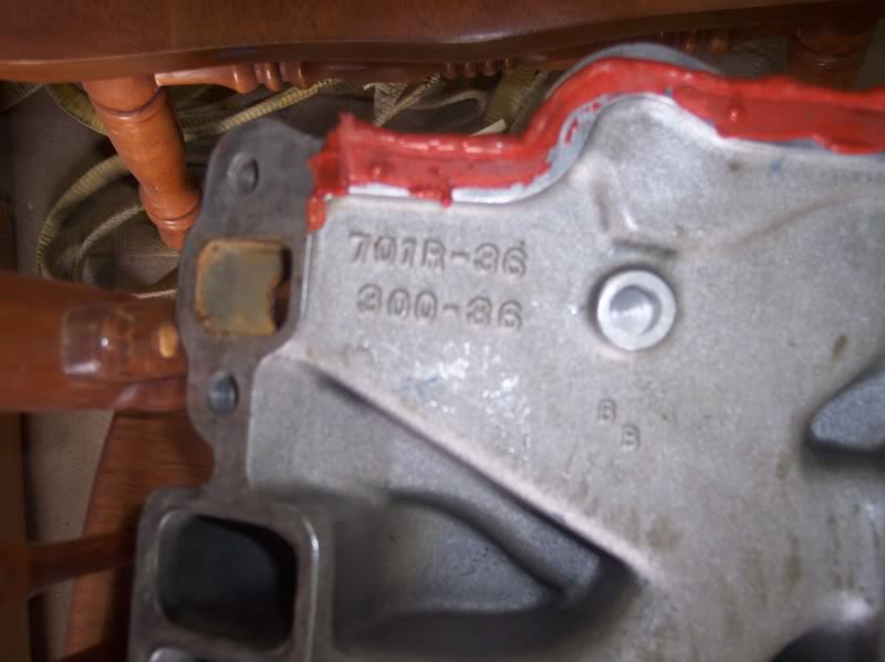

And got the Holley Contender 300-36.

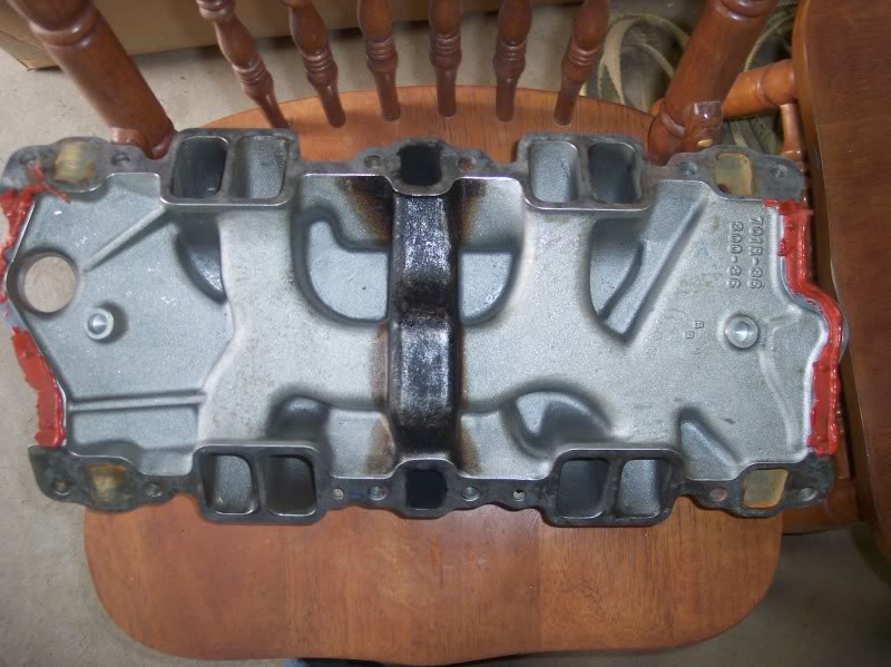

Mmmm, parts! Is yours primarily a summer car? If so, you can block off that crossover in the middle. You can see where the oil was baking onto the manifold. With it blocked, your carb will be a happier camper in the heat of the summer.

Yes, a summer car only. Maybe a bit of spring fall, nothing serious though. Never heard of blocking that off, but I new to this. What gasket do you use to block it off with?

Most intake gasket sets come with thin metal block off plates that you attach to the gasket. Without it blocked, exhaust heat crosses through from one head to the other. It's there to warm up the carb for winter driving. But in the summer, you don't need or want to heat up the carb.
Old Mar 24, 2010 | 07:32 PM
  #117
Very nice stuff! A lot of the newer intake gasket sets come with a small tin insert that sits over the heat riser hole. If not you can easily just put a piece of aluminum foil over each side of the intake gasket at that point and it will block the heat off. It can't go anywhere or do any harm, so it doesn't have to be perfectly sealed. The foil is thin enough to not create a issue with sealing the intake runners if you just put it on the heat riser port.
