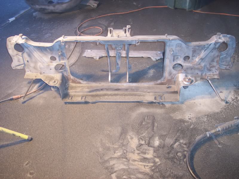

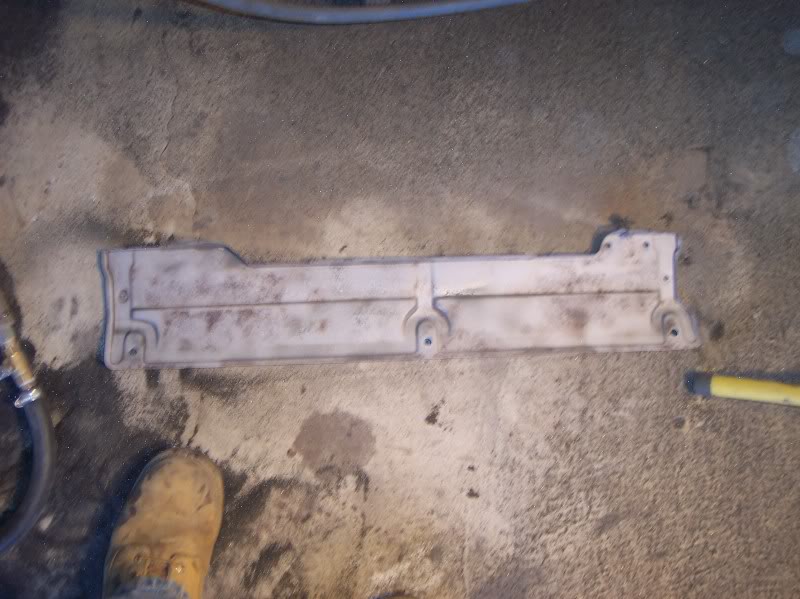

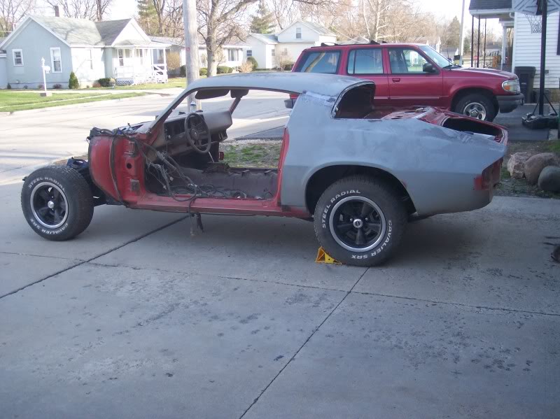

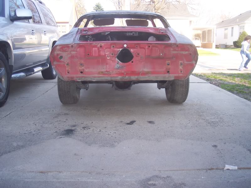

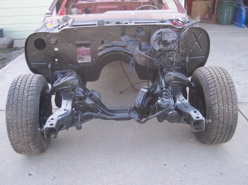

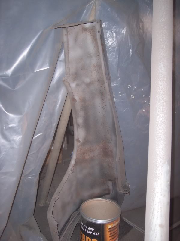

Spent the last couple of days working on parts, mainly the larger ones, fenders, core support, inner fender wells, and my cross member. I have found one fender to have holes in it, not sure if it is fixable or not, for now I am going to try to find another fender, seems easier to just find a solid one than weld on something that can just be bolted on clean. My car also saw the light of day yesterday for the first time since last fall, it only makes me want to finish it more. I cannot believe how light the car is with nothing bolted on to it. The shell probably weighs less than 500 pounds rolling.

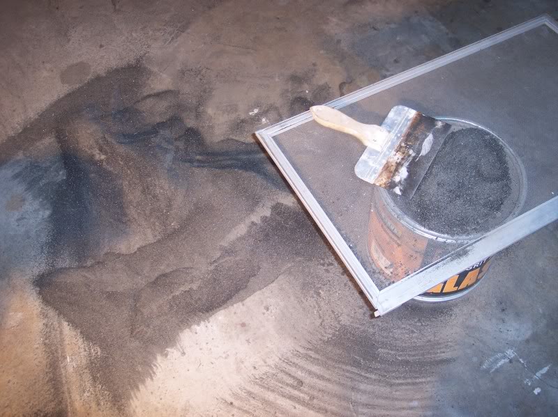

This is my method of screening the media for sandblasting. I sweep it into a pile, and use a plaster knife to put it on a screen to sift it into a bucket. I would estimate that the media lasts about 15-20 minutes in the pot.

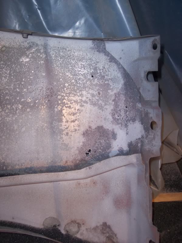

Here is my bad fender, I haven't gone after the other side of the fender yet, and once I found the holes I quit blasting on the back side. I need to see what my father in law says about it.

The core support:

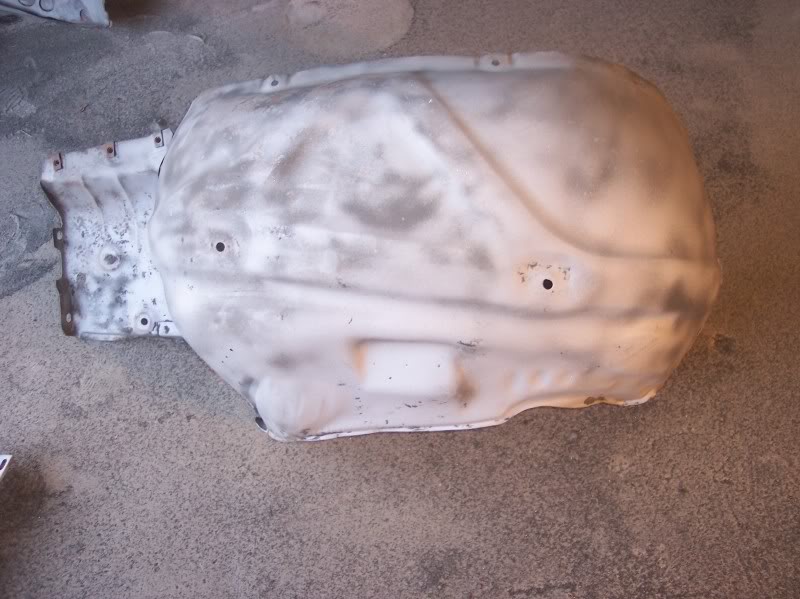

Fender well, I still need to get to the other one.

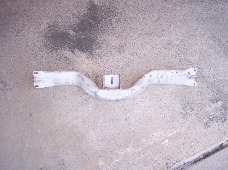

How is this for a crossmember?

I think that fender with the holes could be salvaged, and I'd sure try to before buying repops! Repops are junk! For $25 ea. you can order the bottom 17" of the front fenders and weld them to your's at the body line. I'd do that before getting new ones.
NPD has them under part #C-302-1RH or C-302-1LH. Page 133.
