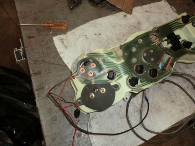

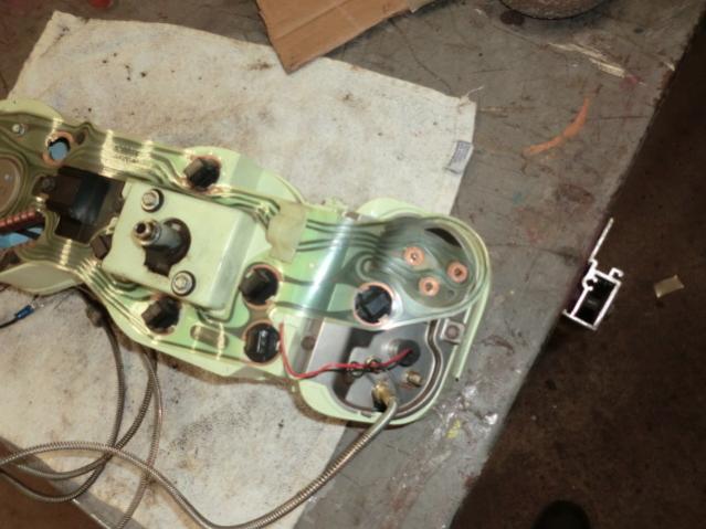

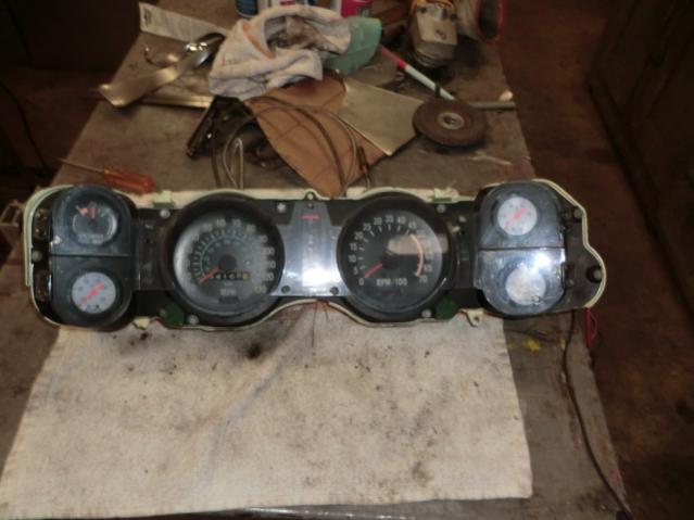

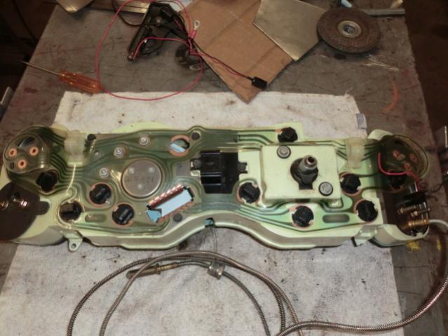

My car is a 76 w/AC. I forgot I modified my dash panel. I removed the factory guages and instaled aftermarket ones. You will see that I have removed screws fro the printed circuit. I didn't cut anything though.
Ignore the red wires hanging as they are fom the aftermarket lights. Also ignore the spring looking thing as that is my water temp.

hmmm ya everything looks right . . . anyone got one pulled out but still hooked up to the wires ? Im still having trouble here
