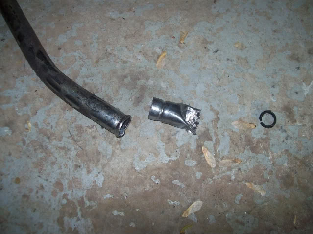

Is it hard to replace the dipstick from my tranny (th400), i cracked it at the base (im sure) when i tightened the tranny to the block.
Old May 15, 2010 | 03:17 PM
  #183
The tube end has an o-ring and slides into the transmission housing. It might be a snug fit, so you may have to give it a good wiggle and pull.

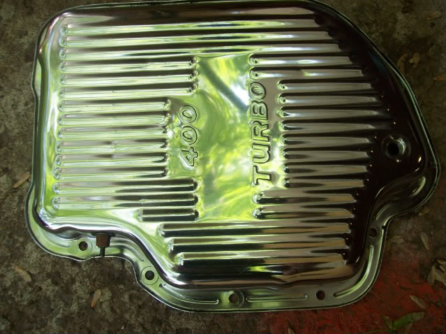

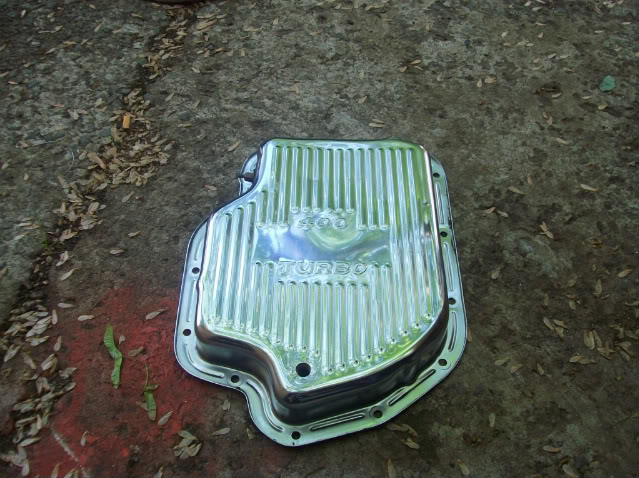

Well not much work today but i did get something done, i had to remove that transmission dipstick, i tugged on it and it snapped off in the tranny, so i had to take the pan off to pull it through the bottom with a pair of vise grips (PITA with slippery hands lol), i figured since i have the pan off i might as well clean it up before i put it back on (full of tranny fluid from the leak).
